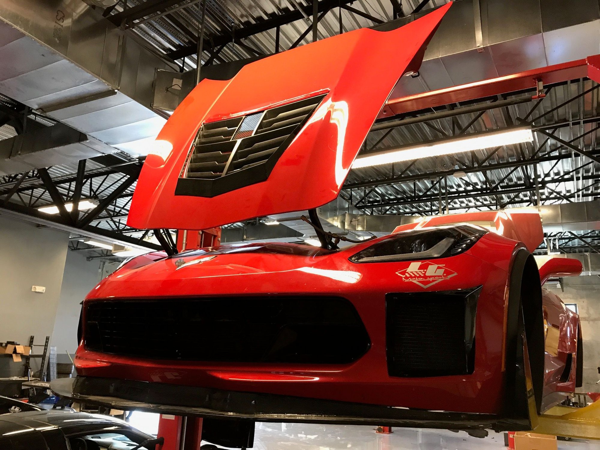

Heat and transmission depending on what you are doing with the car. We've been doing a lot of cooling kits for guys that track their cars down here. We switch it to a twin intercooler set up on the front, then run dual oil cooler and trans coolers with a larger trans oil pan to correct those issues. New intercooler locations, and larger louvered hood section
