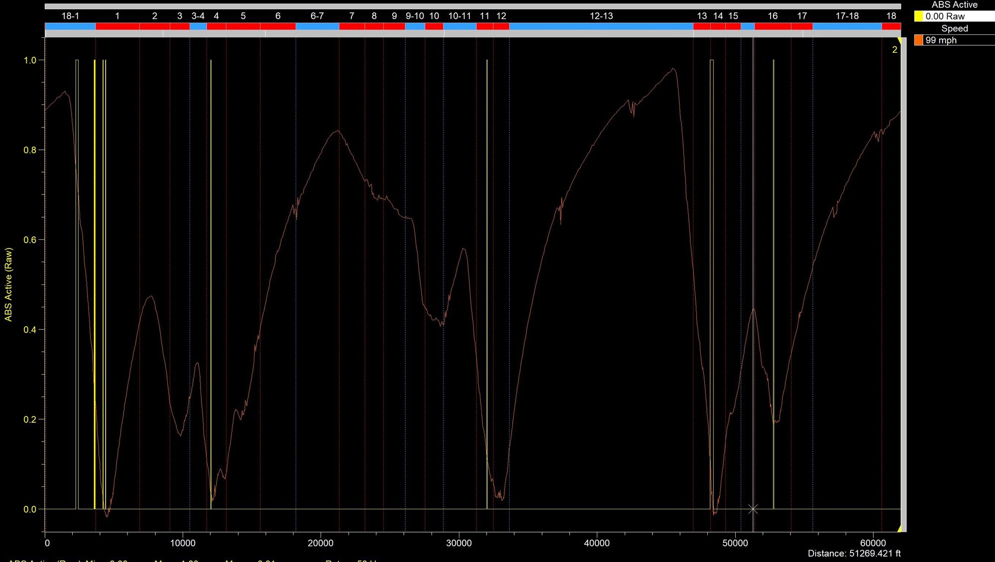

The ABS is working on this car all the time if you're braking hard, but it's usually in the form of it dynamically adjusting the brake bias so you might not feel it. Check out this chart of the ABS Active and Speed channels from a lap of VIR.

Poor-sha, please help me understand your chart and your statement. I wasn't aware the ABS was capable of adjusting brake bias. I assumed it was simply waiting for its sensors to tell it you were in need of assistance. Interesting to hear that it's lurking and working all the time. Your statement implies that it's modulating the pressure to the calipers all the time. Am I understanding this correctly?

Correct, I believe the C6 had this as well but it's dynamic brake bias. It adjusts rear brake pressure based on steering input and other factors. I will say that it was far more noticeable on my 2015 Z06 than my 2017 Z06.
