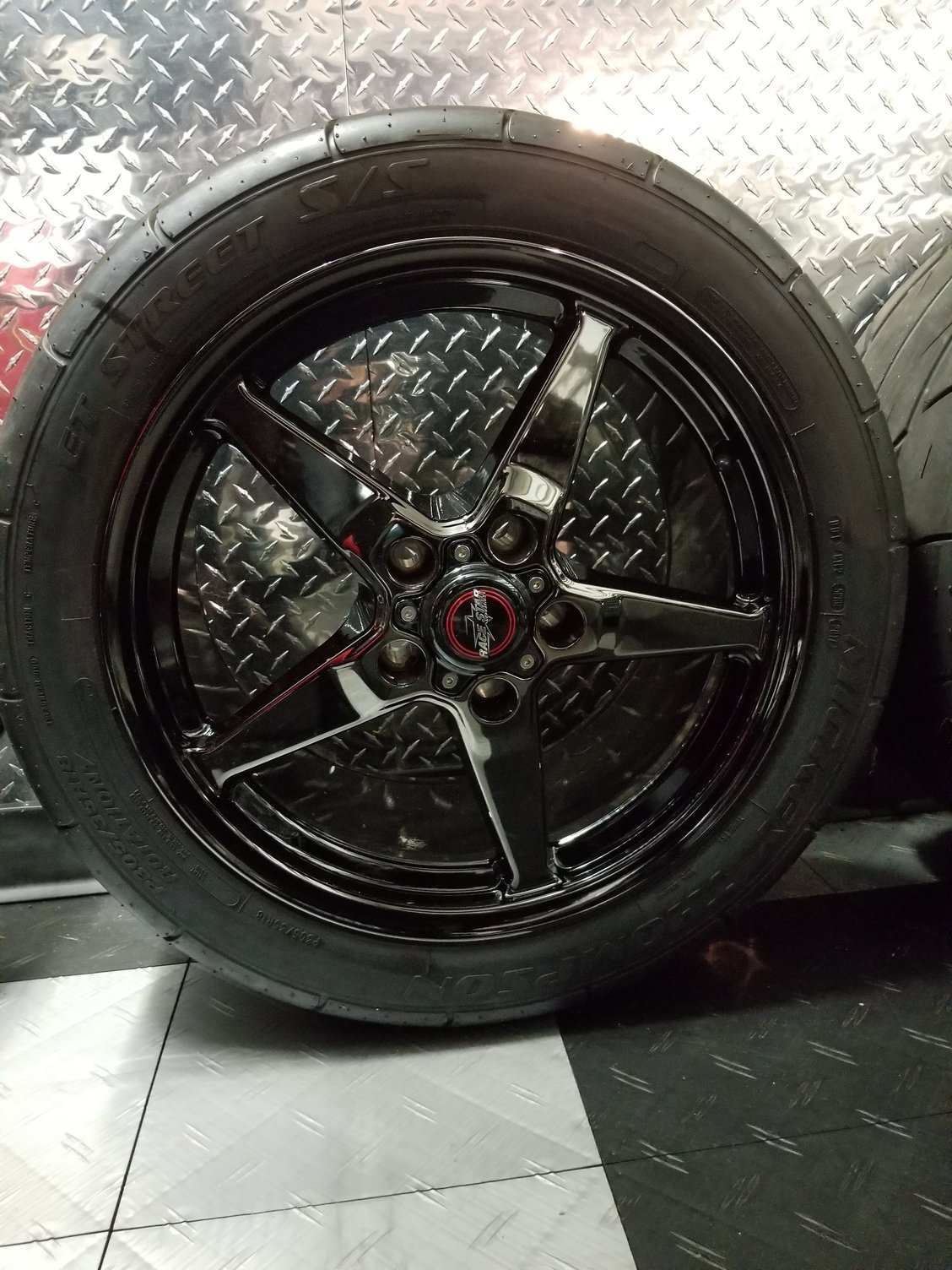

I just have the rears for when I go to the track. MT ET Street SS 305 35 18. With the 75mm offset they fit in the fender without sticking out. I run Nitto NT01 315 30 20s for my street tire on a 20 x 11 rear wheel. The mickey's have to much sway to run all the time for me.

Thanks for the pic 👍 looks good. I was going to run the et street but since I'm going all in now with the skinnies up front and it's going to be a track set up might as well do the Hoosier slicks on back.
