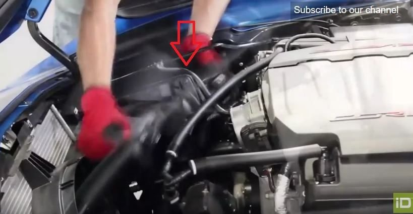

I had such a hard time getting the new filter back in without damaging anything that I am just too lazy to use a filter that I have to remove more often to clean..
I noticed that even in some of the videos, the installer removed the whole air box because it is difficult to get the air box cover back on in the limited space.. I was mainly concerned about flexing the coolant line that runs over the top of the air box too much.

You are definitely correct on it being a PITA! I have the entire AFE intake and it's a lot easier than the OEM intake R&R procedure.

I just did not like how much some of the videos showed they were having to flex the coolant line to get the whole box out..
I got my cover back on with the box in place, but only after putting a soap solution on the box and rubber surfaces of the new filter...
