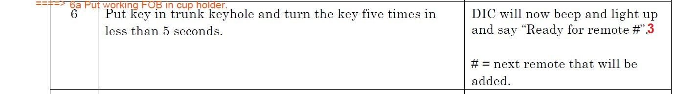

The instructions says "Put key in trunk keyhole and turn the key five times in less than 5 seconds." not sure where you got 10 seconds from

Welcome to the forum! Did you start with step 6 like below screen capture? Did you remember to do step 6a in the attached? See red text. You should see "Ready for remote #3".
What year is your car? 2017 and newer require both FOB's to do short program. See note below that starts with "Also:".

Talk about a needle in a haystack! I was banging my head against the wall trying to get Remote Learn mode to work. Turns out, the trick was to go super fast with the key turns - who knew? That guy's blog post saved me from losing my mind. Now my new C7 fob is all synced up and ready to roll!
