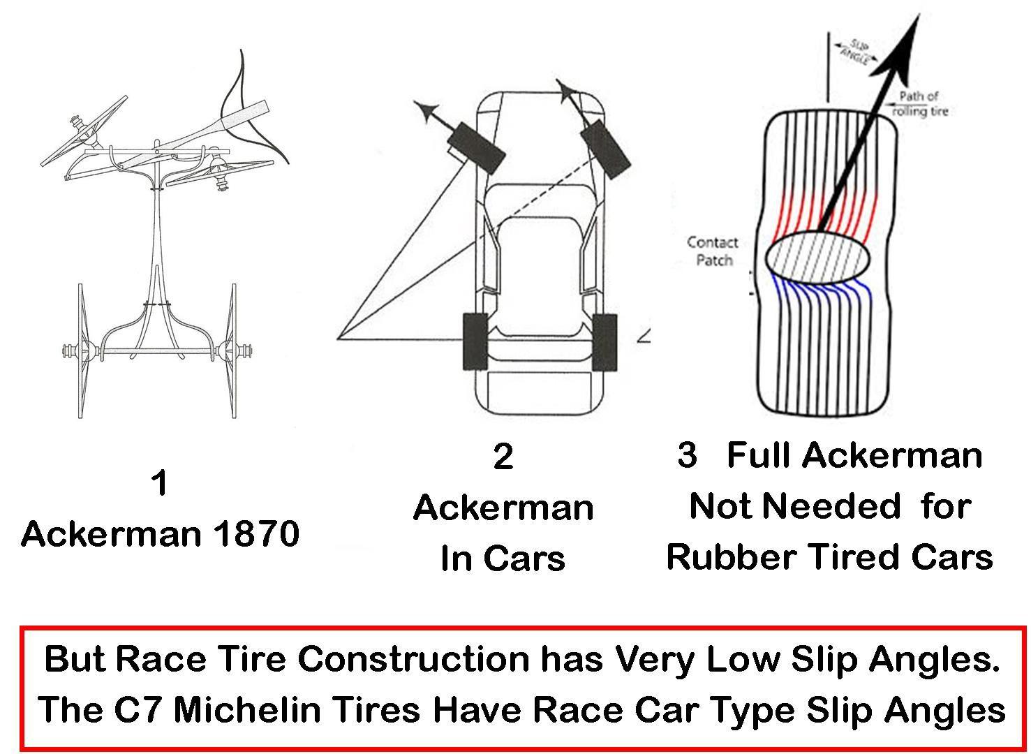

It's NOT the run flats nor simply Ackerman steering geometry, it's the high performance Michelin tires race car type very low slip angles!
Yep if you buy lower performance tires with higher slip angles with the same Ackerman geometry (which doesn't change) and it goes away! If you like the high lateral "g' force you can achieve when warm best JSUT to understand what it is! This is a PDF I researched when my early September 2013 built Z51 was so bad on the first cold day with the SAME tires width I had with my C6 wanted to to find out why! Check it out: http://netwelding.com/Wheel_Chatter.pdf

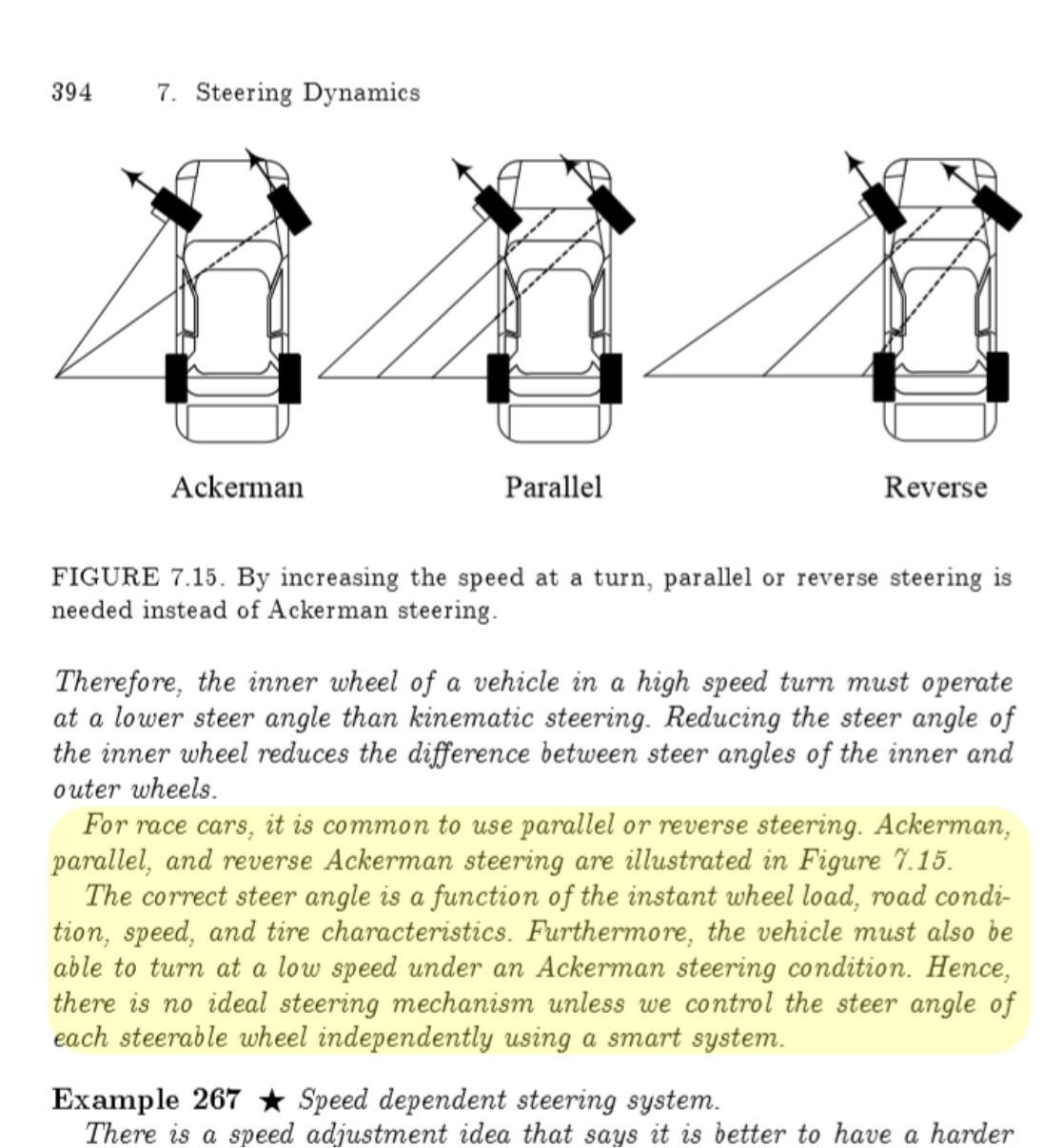

This is one pic of many in the PDF:
PS: It's also NOT the "sticky' tires some say is the cause. Gets worse when the tires are cold and less "sticky" and worse when wet! The PDF defines why! There is also a simple solution I have used for 5 years! When below about 45 F, when I back out of my garage instead of using full lock to go down the driveway I turn the wheel less and make a "K" turn! When warm, like now, a full lock turn does not cause the issue. Usually get these questions when It's cold NOT when it's warm out!

Yep, it's much worse when cold, which is when I make "K" turns. It's NOT just the GM "chatter" GM also calls it 'hopping!" It hops when below ~50 but yes it makes some "noise" when it's warmer! Not enough for me to make "K" turns! For the little extra time it takes to turn the wheel less and make a “K” turn, I think about the ~1.2 "g" peaks I hit around the 75 foot fountain near the end of my street when it’s warm!
Yep as I said it goes away with lower performance tires that have a more normal slip angle! As I note, rubber tired cars don't use "full Ackerman" because it reduces the maximum lateral "g" capability. The Goodyears I had on my C6 Z51, same width didn't do it like the C7 Michelin's when cold. They also didn't perform like the OEM Michelin.
The reason I did the research was it was so bad at 40 F to 50F (doesn’t get very cold either in Eastern SC when I need to drive) and I got and early (September 2013 built) C7 Z51 when there was little info from GM. I recall a forum poster at that time when he backed out of a paring slot after dinner when he temp dropped it "hopped" so bad he got out and looked to see what broke. His wife wanted him to leave the car an call the dealer to flatbed it to their shop!

As I discovered, rubber tired cars don't use full Acreman steering geometry by design as no need since normal slip angles partly compensates. At high speed, since the outside tire in a turn has much higher loading than the inside, it also hurts high speed "g" performance.
Of the many of my own references I used when defining the reason for high "chatter" in the C7 and when cold "hopping" I also found a good Internet reference that had a 165 page chapter entitled "Steering Dynamics." Below is a pic from one page (it has lots of math but some good pics as well!) As noted, to achieve the max lateral "g" force in a turn some race cars use "Reverse Ackerman!" Have an old text entitled "How to Make Your Car Handle" that said that but I questioned it because of the age. However this is a more modern reference! Doubt many if any still do that but chatter when leaving the pits is no big deal!
