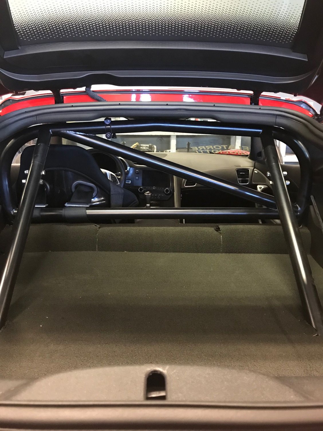

Customer who owns the white road race build we did recently wanted a roll bar so we made a few of them. My phone crashed so I don't have pictures of that one installed but here is what it looks like in our red straight line car. Full cage is something we're capable of if you're wanting to go all out.
How much is this Dane?
I'll check Monday. The one pictured is for the black Nurburgring car but we're in the process of making more.
