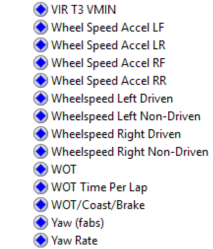

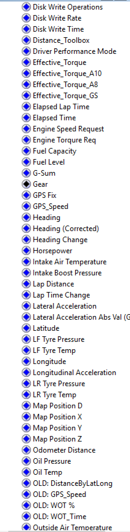

The main advantages of the PDR are:
Ease of use
Data Capture
Once you run the PDR video file through Cosworth ToolBox you find there is a ton of information available. After I had my off track incident in September I sent my PDR video file to Poor-Sha so he could run it through Cosworth's Pi Tool Set. He was able to provide a graph that showed exactly what went wrong in the turn. Unlike previous times through the turn I hit the throttle a little early just as the ground was starting to drop away from the car. As I went to WOT the vertical load went from 100% to 93% which reduced tire grip exactly when I didn't want it reduced and around I went. You don't get that kind of information from Harry's Lap timer or other low cost solutions. Like I have said before the PDR is an excellent data recorder at a pretty good list price and by the way they throw in a Nav system with it. The fact most people can get a discount on the cars nowadays means the PDR costs even less money. They may not be available standard on a 1 or 2LZ car but they are optional.
