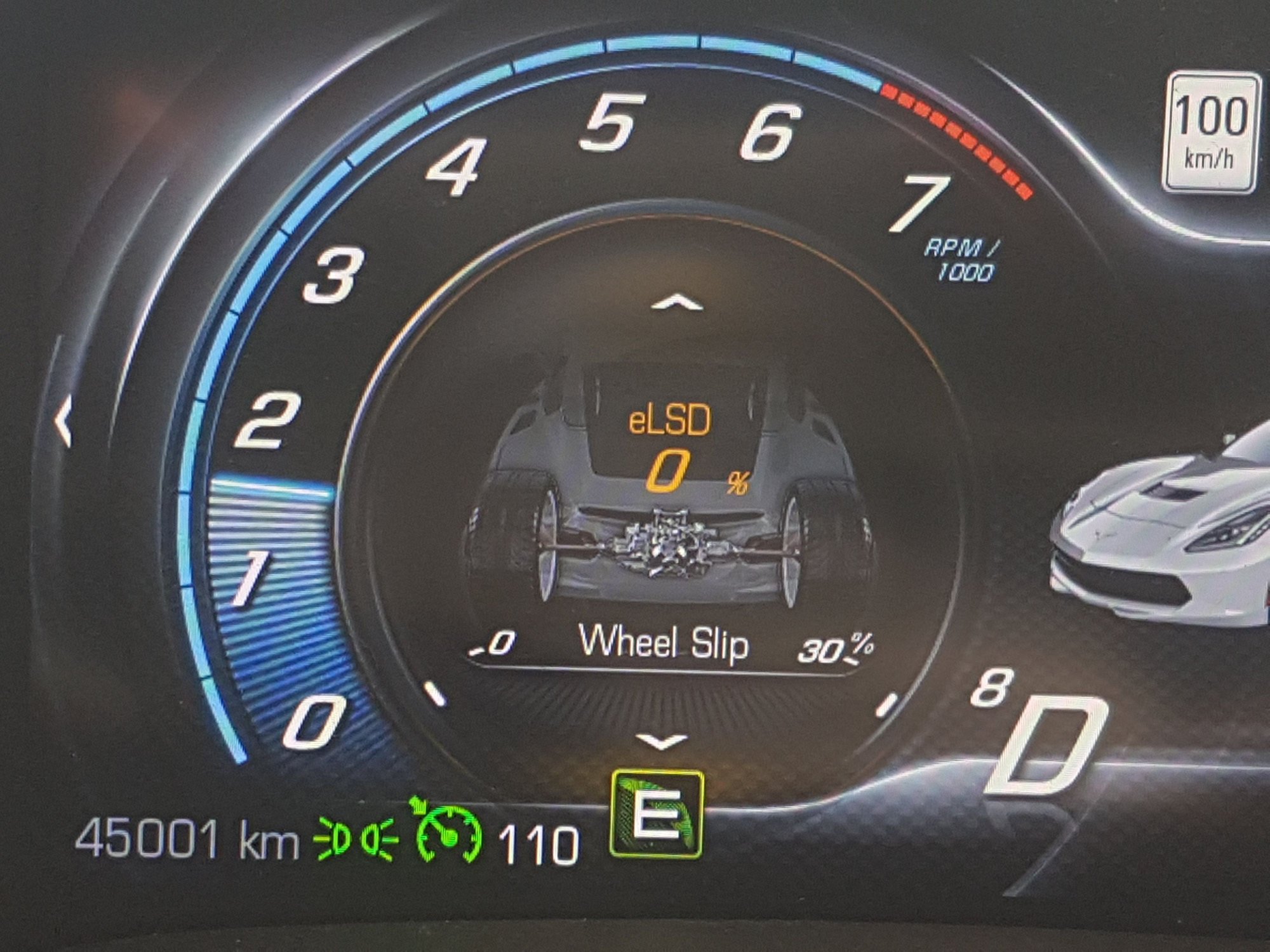

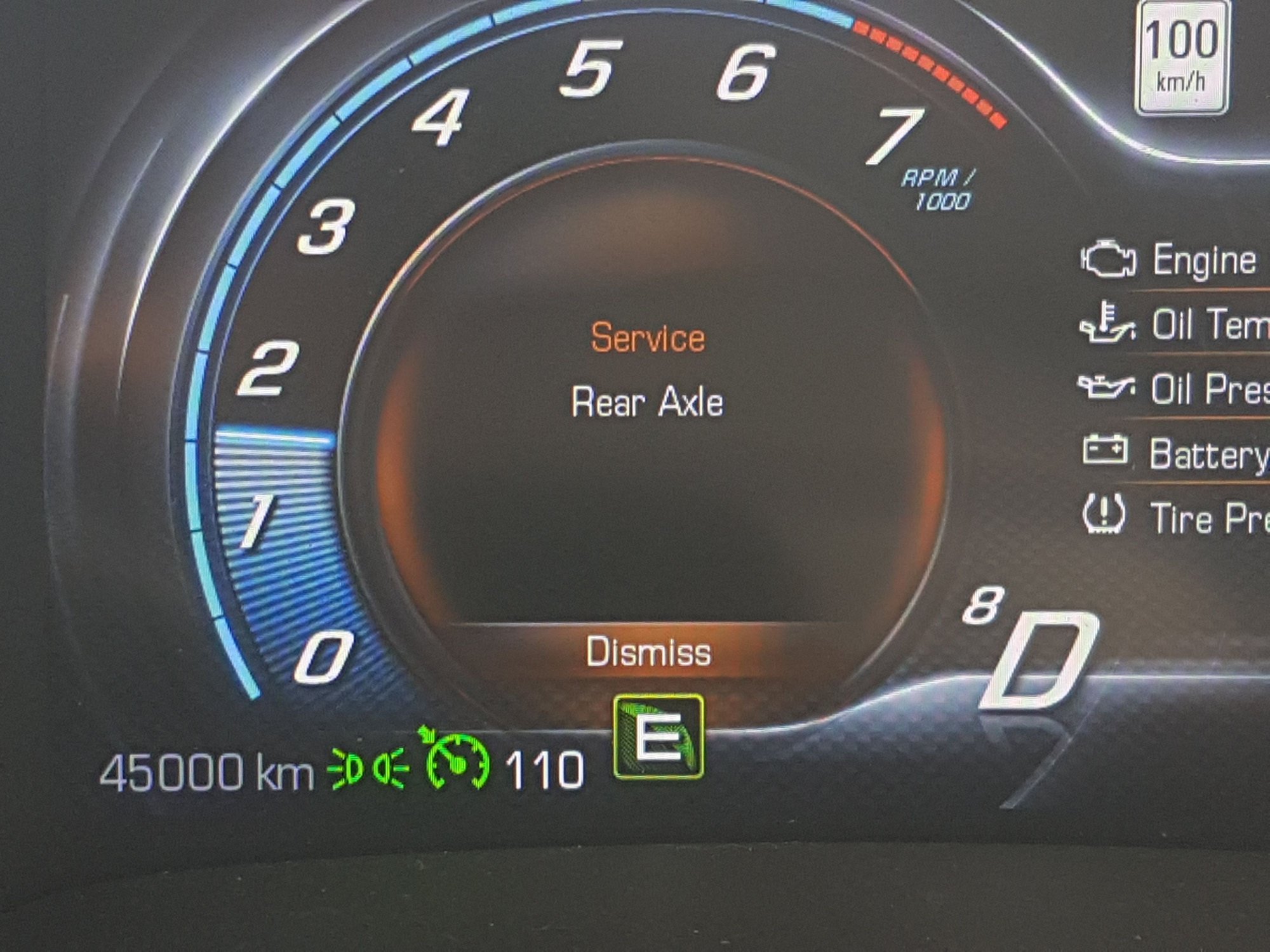

I have a 2017 Z51 and I have had no problems with it except I get a service eLSD notice on occasion. I have taken it to a dealer a couple of times and they can't find anything wrong with it because it doesn't store a code in memory. When the service light goes off the eLSD screen goes to zero until I stop the engine and turn it off, and then when I turn it on everything goes back to normal. This obviously resets the diff, and the car runs fine when the eLSD is deactivated.
Has anyone else run into this problem?

I think there was a TSB for this issue, one of the connectors at the eLSD control module had some issue with a contact/pin not being seated properly in the connector, causing an intermittent connection. Try unplugging and re-plugging-in the connector (s) on the eLSD control module, located under the car, between the muffler and the driver side rear wheel.
