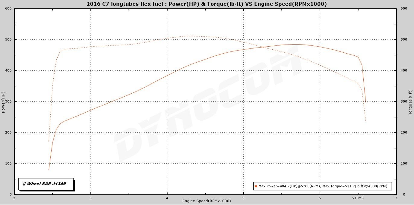

C7 Stingray M7 with 2” TSP catless Headers, 3” X-pipe & E85 Dyno numbers:
Dyno: Dynocom AWD 15000 FX
Stock: 415whp / 416wtq
Stock tune w/headers: 440whp / 455wtq
93 tune w/headers: 460whp / 480wtq
E85 tune w/headers: 485whp / 510wtq
I did change to NGK step colder plugs since most shops recommends it with headers and e85... car ran bone stock 11.6s on 1/4 mile consistently. Looking forward to low 11s ot maybe even 10.99 this coming “winter” in Florida.

Good numbers!

Nice gains for simple bolt on’s. How does the car feel ?

Impressive gains!

Thank you guys! Drivability like stock... only issue is no traction at all when you go WOT at 20-30mph on first gear with stock Michlien PSS tires lol

Congratulations on the awesome gains!

Have the same mods on mine and making right at the same power, but mine is an a8. Love the feel for sure, but am used to the power and want more now. Supercharger....
