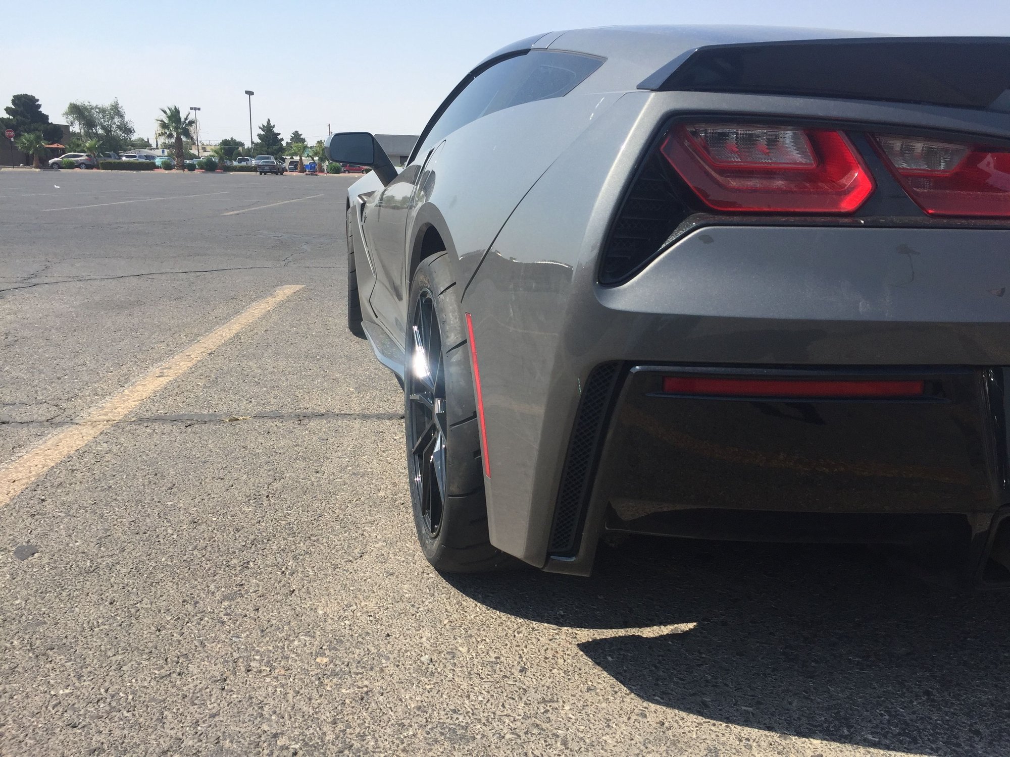

Old Jun 2, 2018 | 09:14 AM
Fast6.3's Avatar
Fast6.3
Posts: 542
Likes: 52
From: El Paso Texas
Old Jun 2, 2018 | 09:22 AM
Fast6.3's Avatar
Fast6.3
Posts: 542
Likes: 52
From: El Paso Texas
On big dips with two passengers a lttle bit otherwise no
