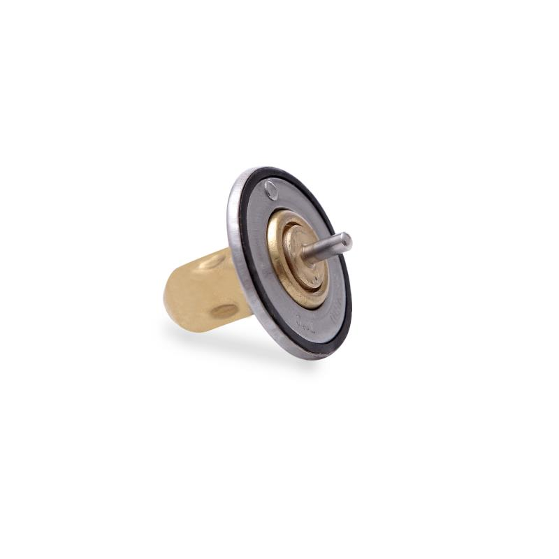

The Mishimoto gasket/housing is just like the OEM. All the others I have seen are like the one you have shown. You are right that the others will fail. Two years in, the mishimoto is working fine.

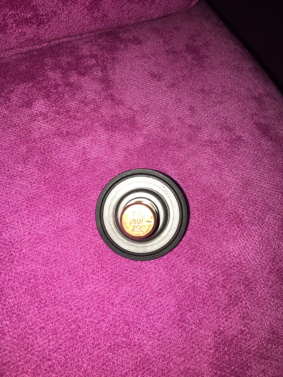

71c degrees 160 F
Oh ****,
i installed the mishmoto TS 4 months ago, but unfortunately failed 2 weeks ago the my Z51 2014 went for high temperature. And just today I bought other one different type.

Sorry to hear that Tariq. The photo you posted doesn't look like the Mishimoto I have. The easiest way to tell is the huge gasket that wraps around the outside edge. This alone wouldn't account for the failure, I just don't think you got a Mishimoto. Maybe it's an earlier version? They have a lifetime warranty . You could get a new one and possibly it would be the updated version?

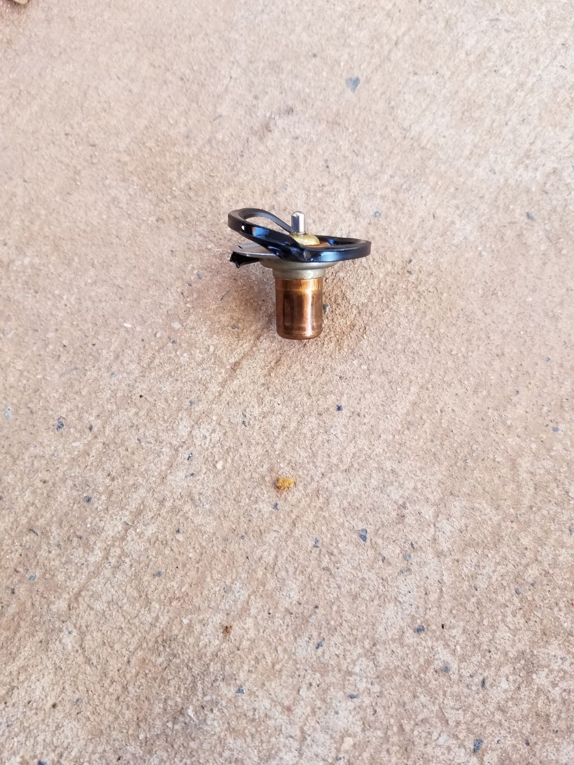

Has anyone had any issues with the newer style Mishimoto t-stat? I’ve had one in my car for a few months and everything was good until last night. Temps started climbing out of nowhere, and everything else seems normal (fan, coolant flow). I’m going to dig into it sometime this week, but I’m suspecting a thermostat issue.

The newer design Mishimoto thermostats look like the OEM parts as far as the seal goes. After seeing all the gaskets come apart on other LT1/LT4 thermostats, I figured the Mishimoto was a safer bet. I was wrong.
I pulled the car apart a few nights ago, and the Mishimoto o-ring was sitting in the housing. I’m not sure if that was causing it to jam, or if there was an issue with the bulb. But it was definitely causing my overheating issue. I swapped it out for a Lingenfelter 160 LS3 stat with billet housing, and all is well. Should have done that from the get go.

Streetk14, Thanks for showing the pics of your bad stat. I hope I end up being one of the guys that doesn't have problems with the Mishimoto. What billet housing did you use? I see you used a LS3 stat-I didn't see anything on the Lingenfelter sight that fit the 2014 up. What was the Lingenfelter part number that you used? I would like to know all this in case I have a problem with the Mishimoto. Any pictures you have of the LS3 stat in that billet housing would be great. Thanks Again!

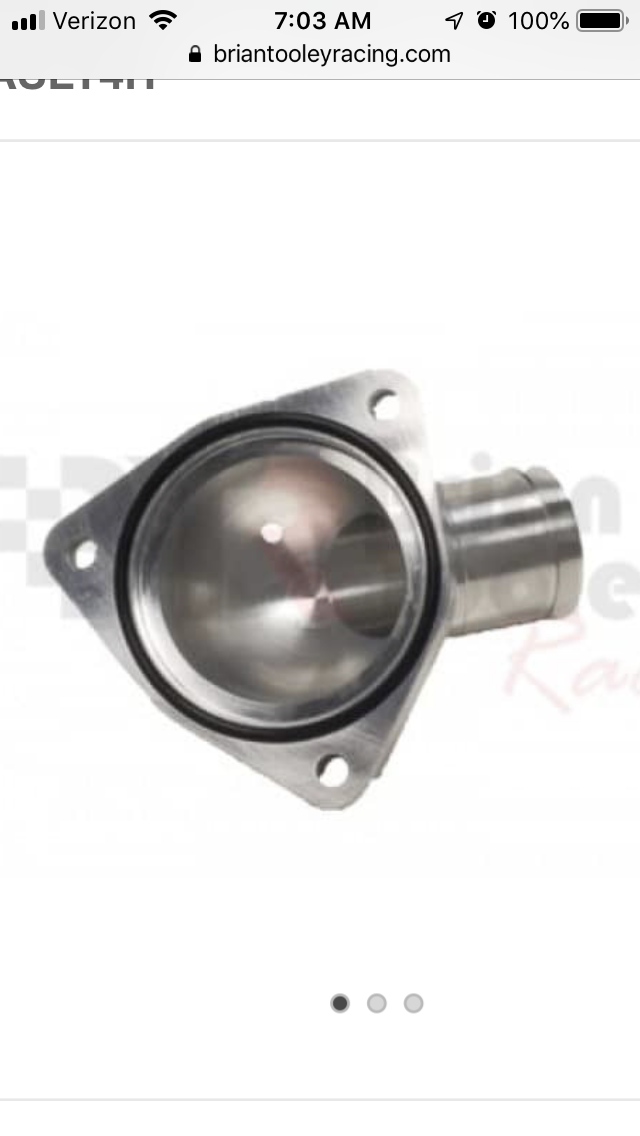

I bought the billet housing from BTR. I believe it was made by Dasilva Motorsports. LMR also makes a billet housing that uses any LS3 style thermostat, though it’s a little pricey. Those are the only 2 on the market I know of. Lingenfelter doesn’t sell them; I just bought the thermostat from them as I’ve had good luck with them in the past.
You’ll find the one I bought on Brian Tooley Racing’s web store. Then you can use whatever thermostat you want. I think I’m going to switch mine out for a 174.

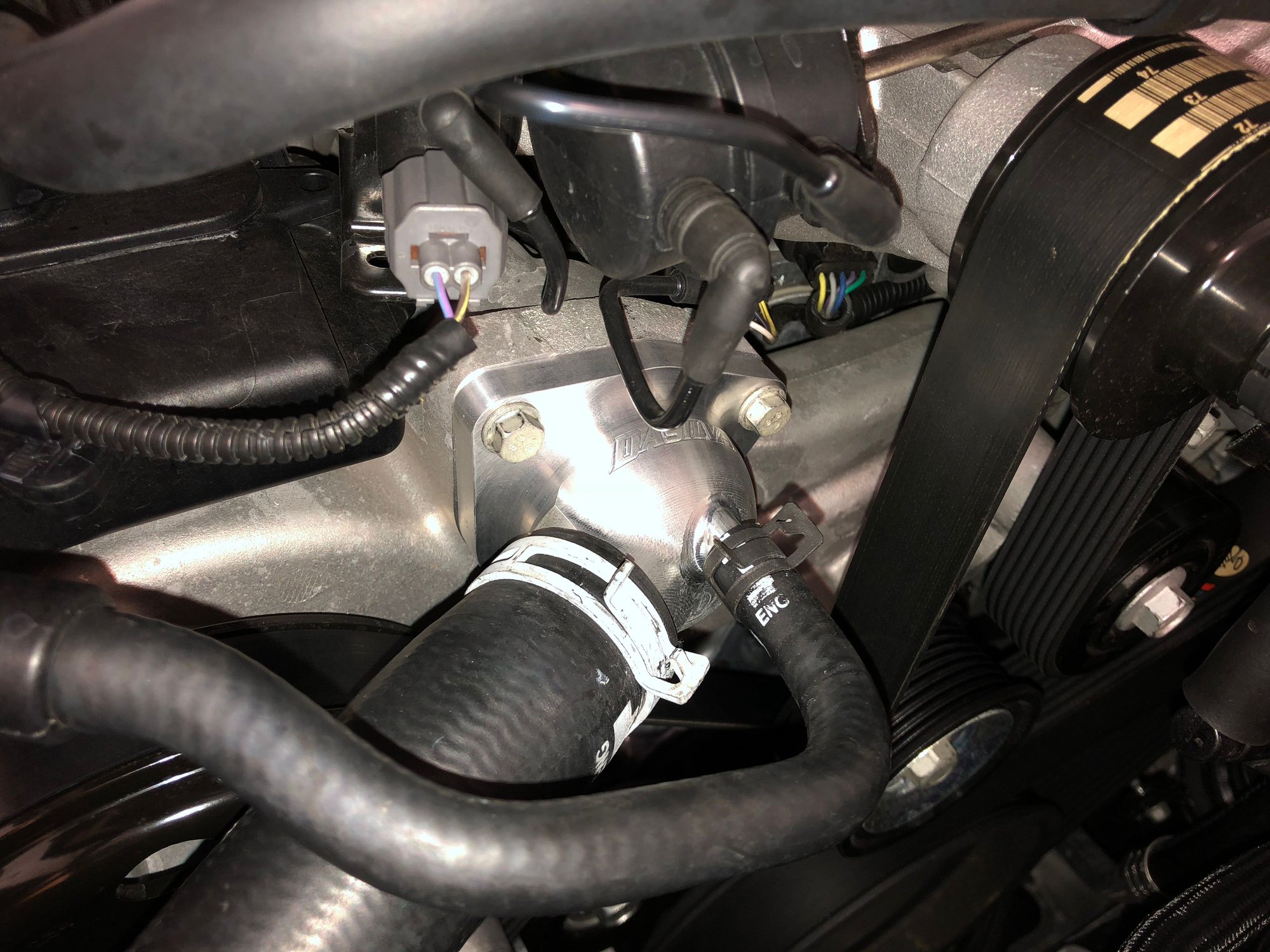

Here’s what it looks like installed. I didn’t take any pictures before I put it on, but it’s a nice looking piece.
And yes, it’s on a ZL1. Works on Any LT1 or LT4 engine.

Sweet setup. I will look them up if/when my Mishimoto craps out on me. I think I would go with the 174 also. My 160 actually seems a little cool. My tach takes a while to show its warmed up. Thanks again!
