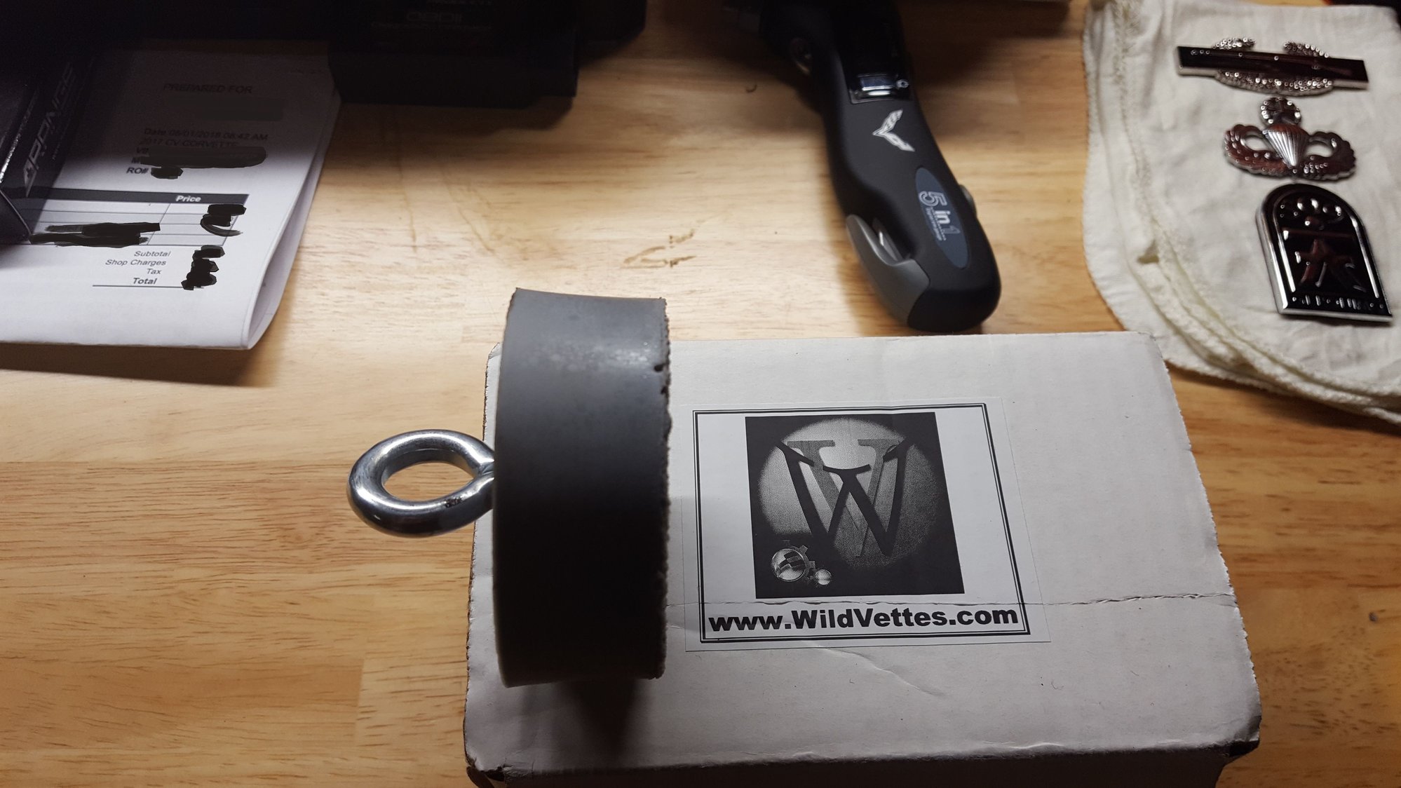

I agree with Fleming. I use the same HF Pittsburgh floor jack with no problems. I use these pucks and have had no issues lifting the car. I have a 17 GS with side skirts. About an inch of clearance on the sides. Jack stands are needed as well.

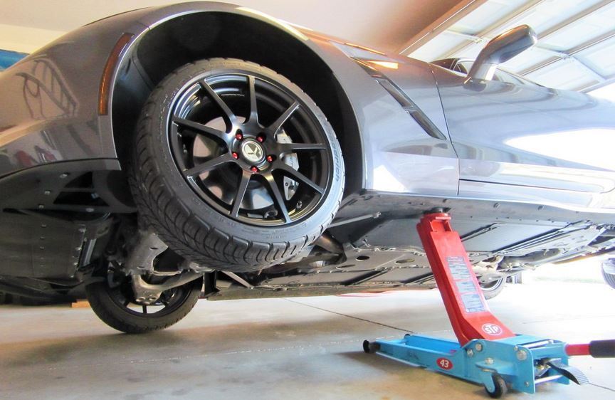

Likes: 9,820
Originally Posted by Kracka
The 1.5 ton blue & silver aluminum jack from Harbor Freight works perfectly with the C7.
I agree. The 1.5 Racing Jack is excellent. Light weight, easily moved around and will get the car plenty high. I jack the car from the front shipping slot near the front of the doors on each side and lift both wheels off the ground at the same time with it. Really helps when changing wheels at the track.
https://www.harborfreight.com/15-ton...ump-62160.html
