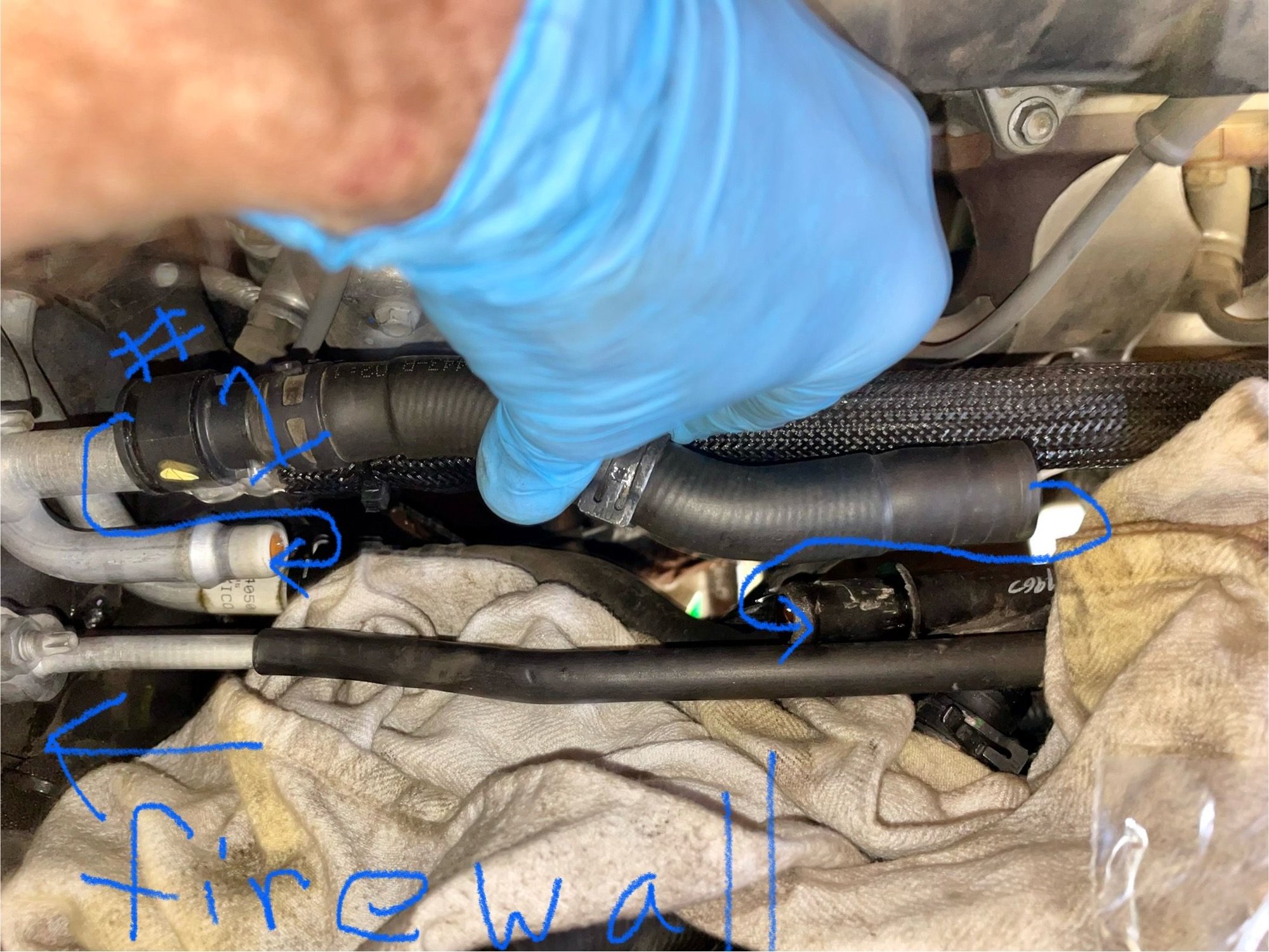

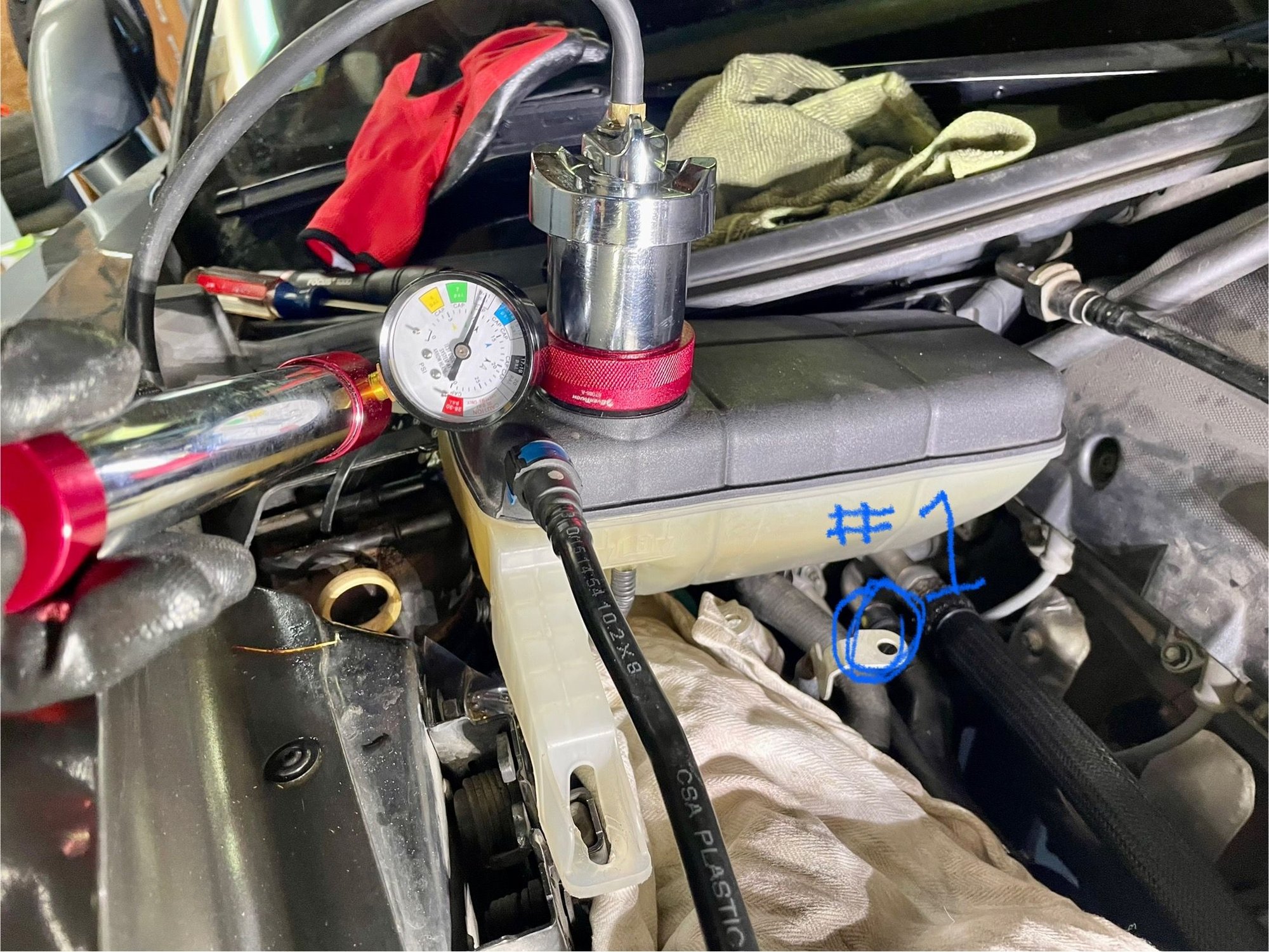

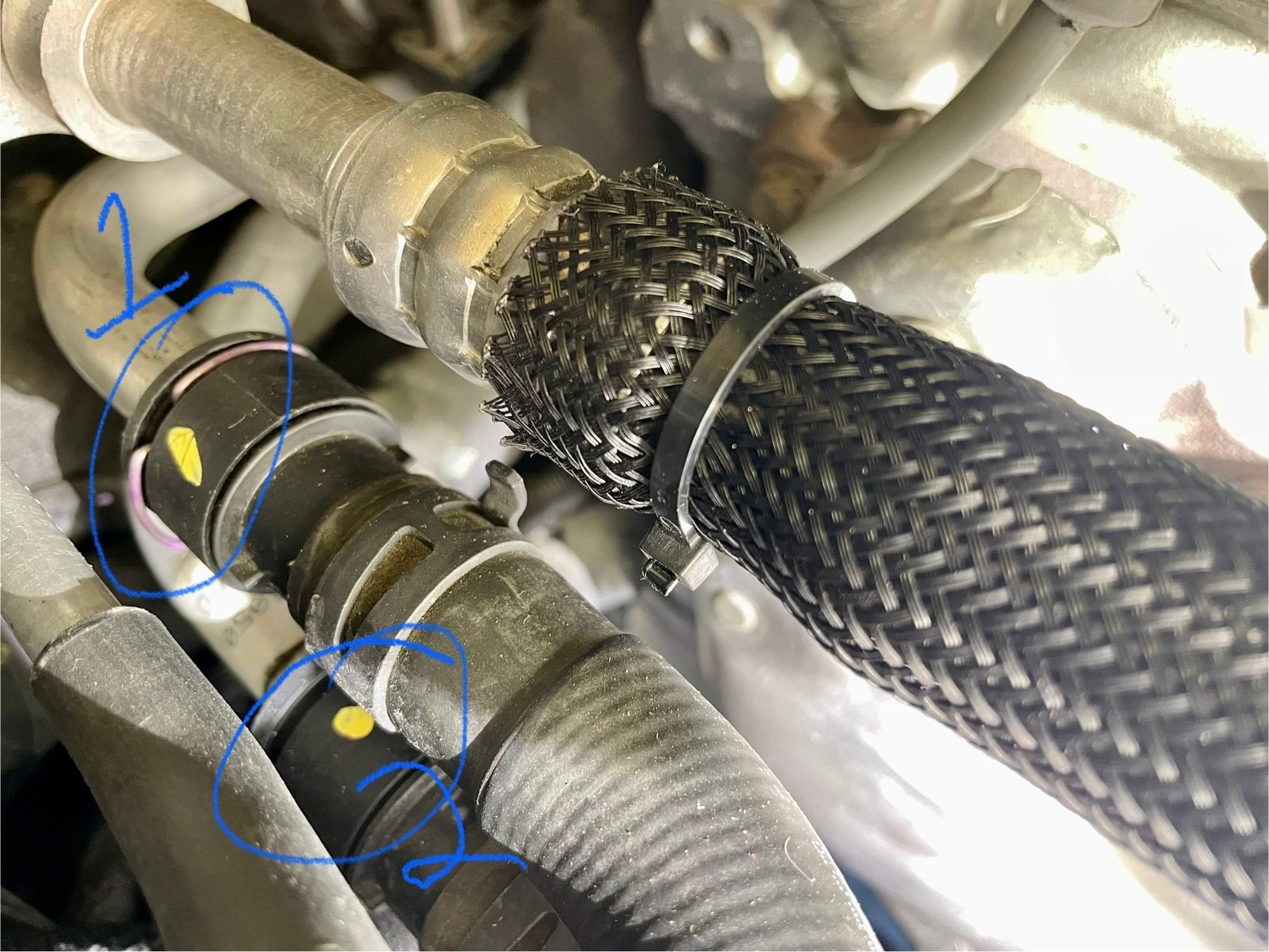

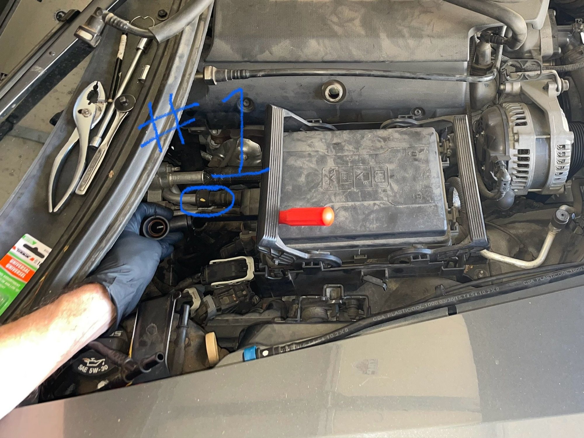

Well, it turns out the tank connection was not leaking, but heater hose connection # 1 as marked in attached photos was the culprit. It took one of the larger o-rings (not largest) in the same Dornan 80020 assortment. I just matched it up. Again, tight fit.
I also learned (accidentally) you do NOT need to remove the “paper clip” keeper to reinstall these connectors. Put the keeper back on and give it a good shove and he sure to pull back on it to ensure the hose is locked on. Same on bottom of coolant tank.
Connector marked #1 was the leak
Goes to same y-connector as coolant tank hose
Testing after replacing o-ring.  Loaner from O’Reilly’s.
#2 was not leaking.  These 2 hoses, along with the coolant tank hose and the y-connector, make up the heater hose kit mentioned in this and other threads.
#2 was not leaking. These 2 hoses, along with the coolant tank hose and the y-connector, make up the heater hose kit mentioned in other threads.
