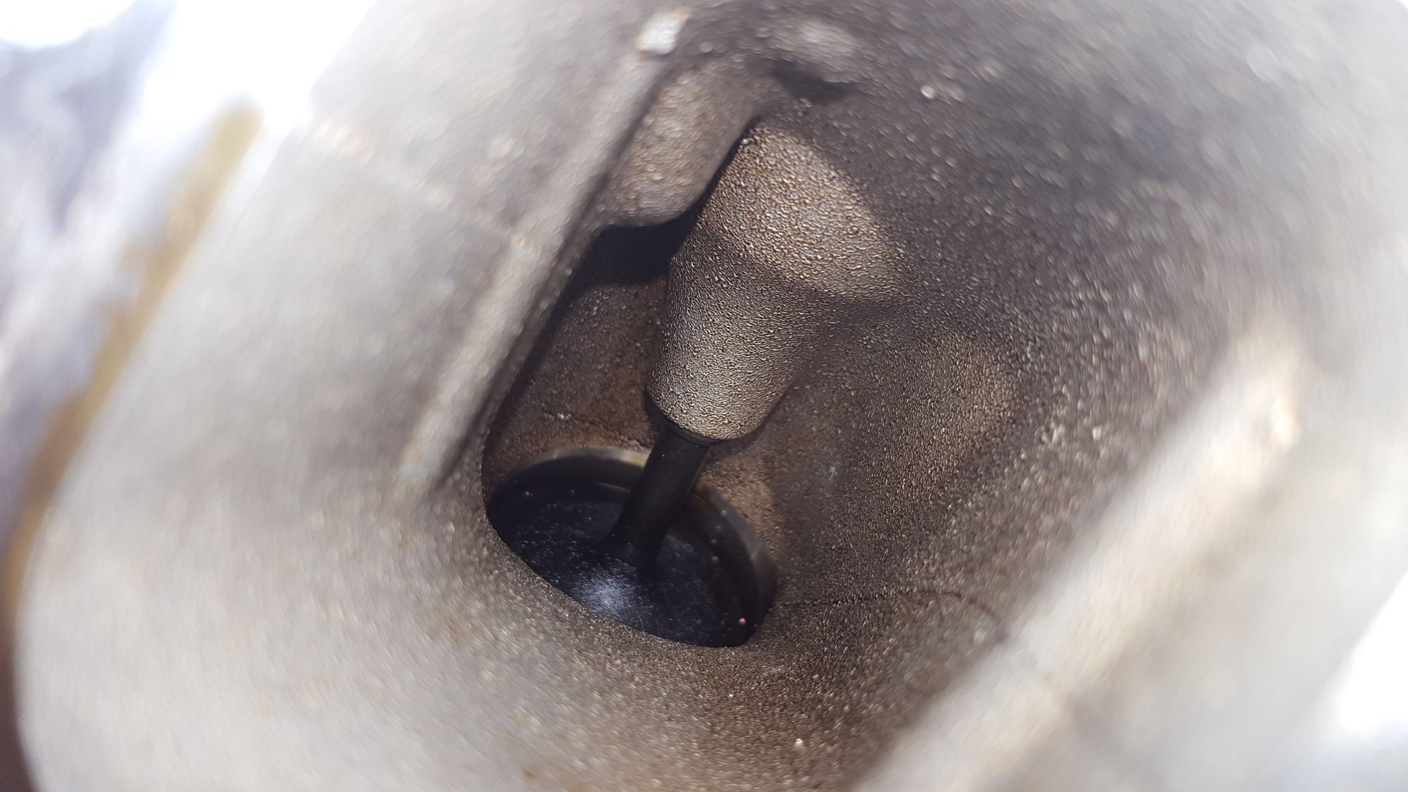

For what it’s worth, I just had a cam and heads package installed on my 2015 Z51 at 10,000 miles. The old intake valves and ports shown essentially no deposit at that mileage. I have an elite catch can and the total accumulation of liquid has been less than 6 ounces in 10,000 miles. My conclusion is that GM engineers have designed a pvc system that essentially makes deposits a non issue.

Pics of my valves at 10,000 miles.

Thanks for the Pics. I agree they did a good job but it's not a "none issue." If it was a "none issue" they would not have spent the time and engineering effort to improve the PCV system with lines going from the dry sump take to both valve covers another to the auxiliary dry sump tank and who knows what's inside the block. I collected about 10 oz in 10,000 miles in my 2014 Z51. Now collecting ~half that amount in my Grand Sport with the new PCV system. Although the short PCV hose and valve are in the same location in the Grand Sport as my 2014 Z51..
Now we need pics of someone who didn't have a can!
