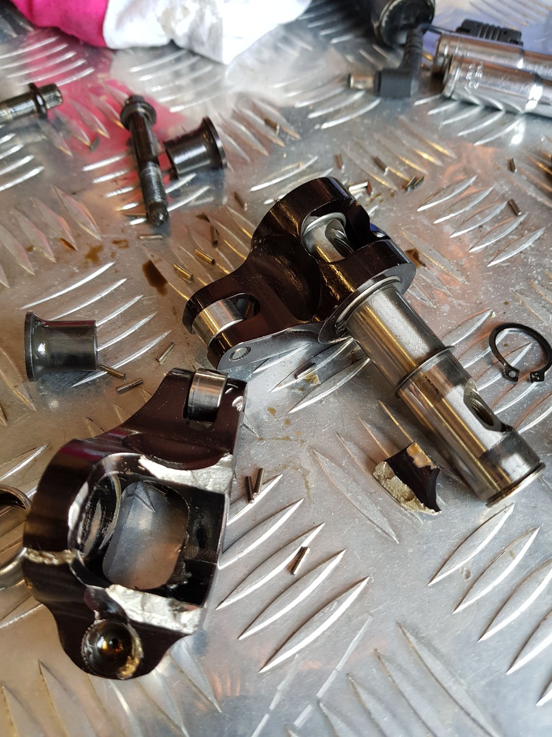

I have just pull a set of PCE261.1246 Speedmaster procomp ls2-3 Shaft Mount 1.7 ratio black Aluminum rocker arm set after one broke less than 2000klm with pac1208 valve springs and 130lb seat pressure.

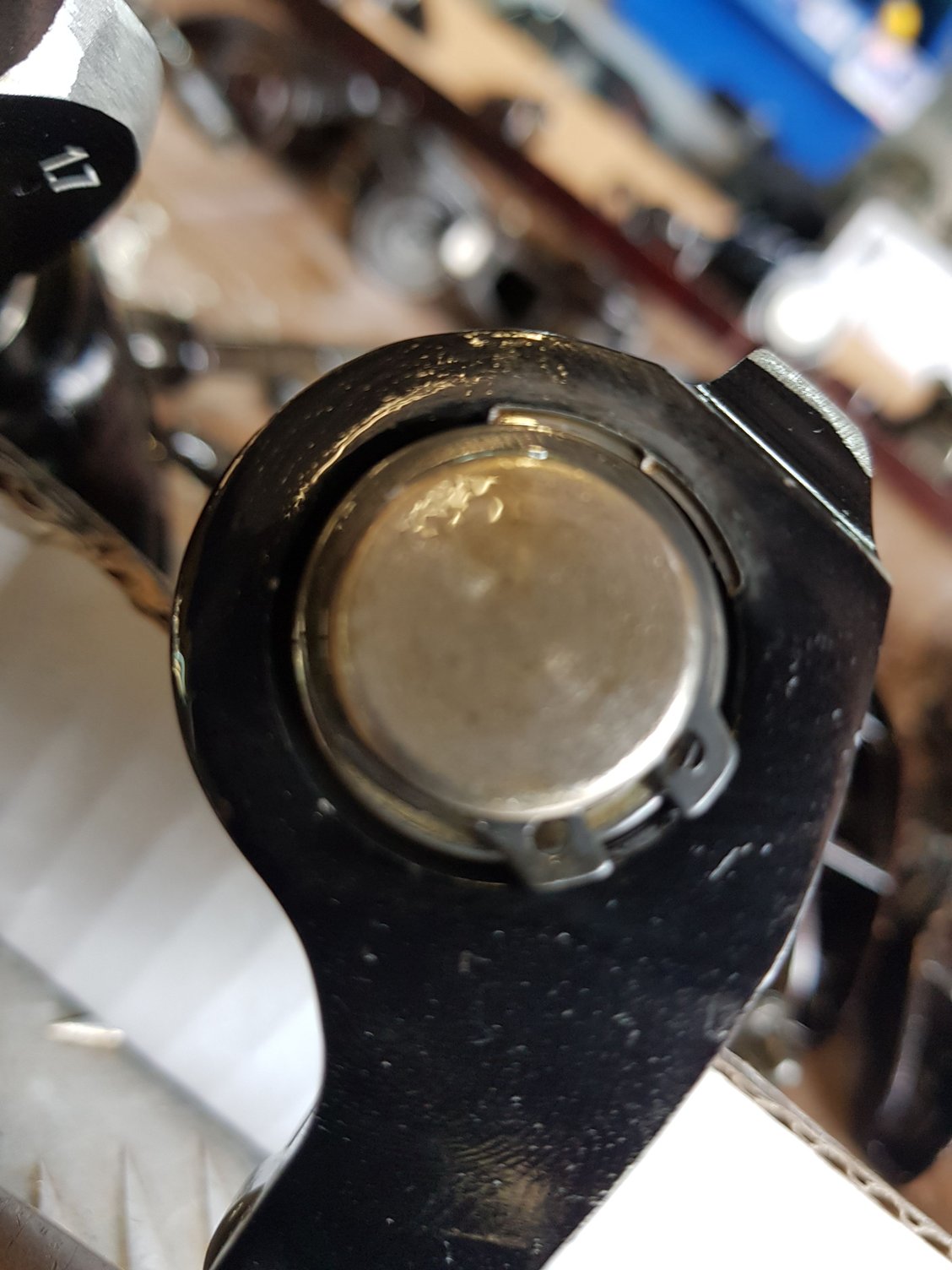

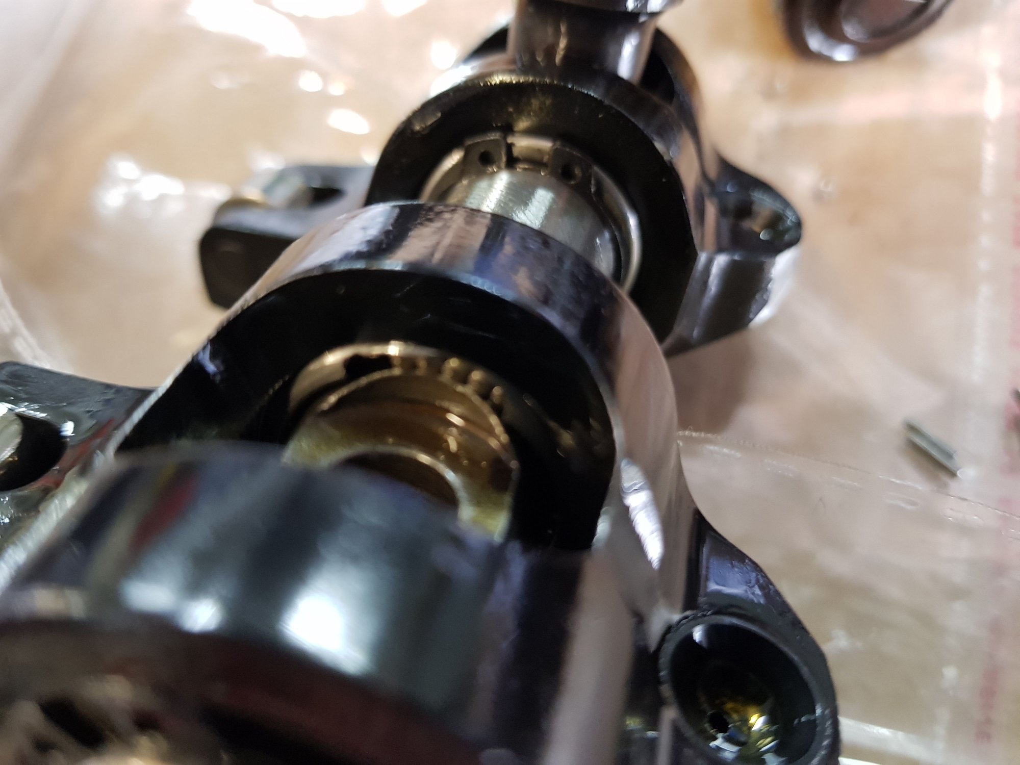

5 sets of rockers had there needle roller cages worn through the edges exposing the needle rollers and 4 had the rocker retaining circlips wearing into the rockers making metal.
This could have been messy BEWARE!!!!
Broken rocker
Worn roller cage
Making metal

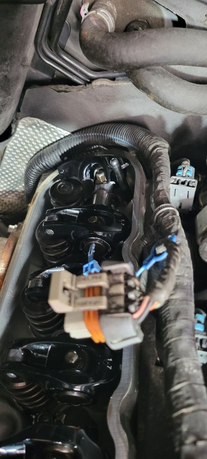

I had the exact same ones on my freshly rebuilt l77 6.0 (my first rebuild omo) but less then 300 miles, and a winter of sitting I'm driving along and tap tap tap tap I'm thinking the worse but it wasn't what I was thinking no lifter or piston damage but it put the car down another 4 months at the beginning of what was gonna be its first full season
