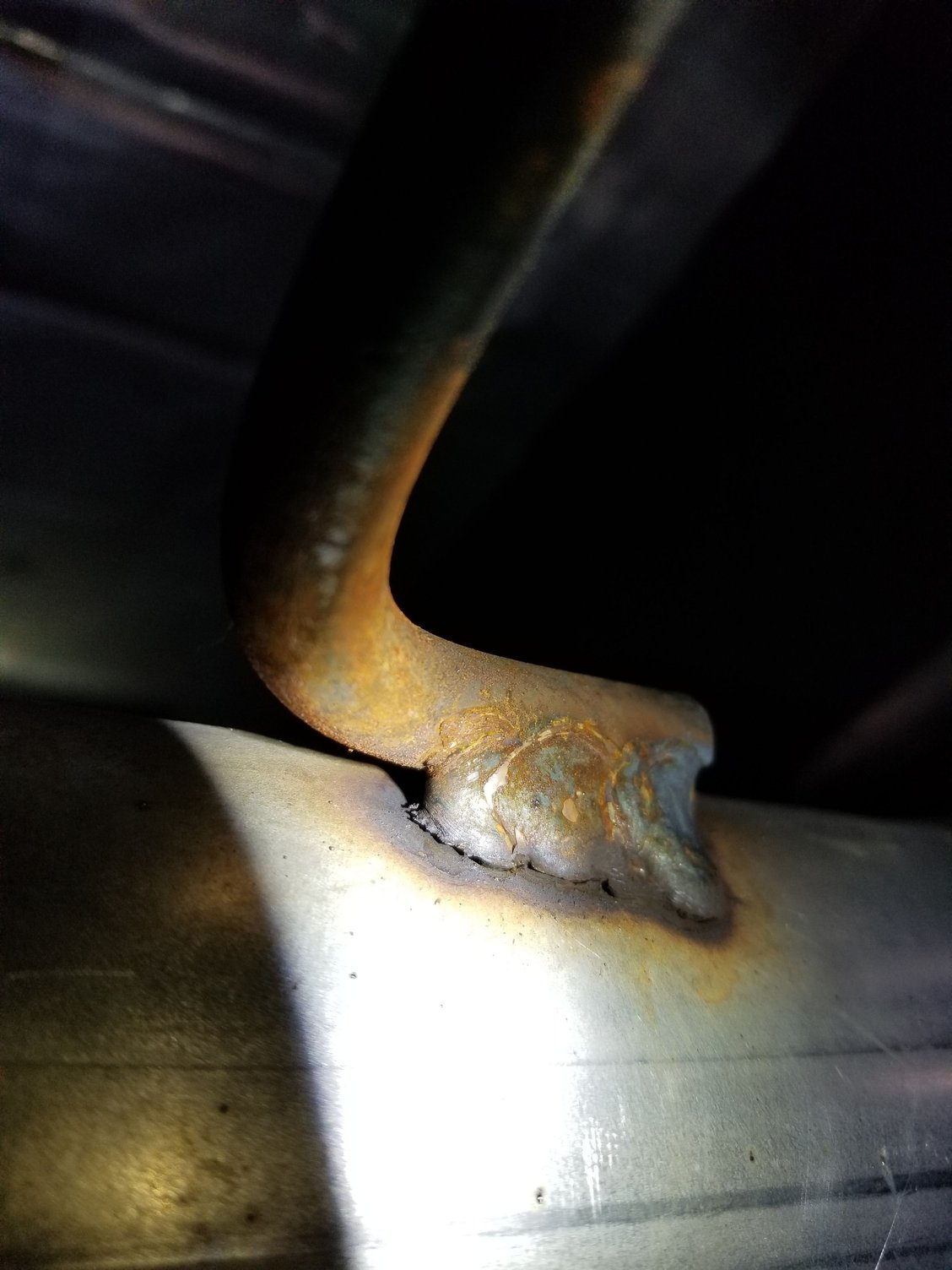

The piece of metal connecting both mufflers together ended up being the cause. You can see it start to separate in the pic when you pull the mufflers apart.
That stinks. Can they fix the weld without having to remove anything?

I took it to an exhaust shop today and it was a pretty quick fix. Hopefully the weld holds.
