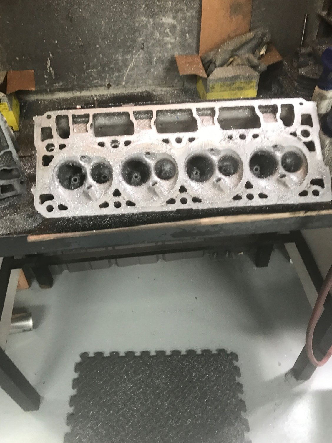

Default Hand jobs are best LOL
My lt4 heads...
