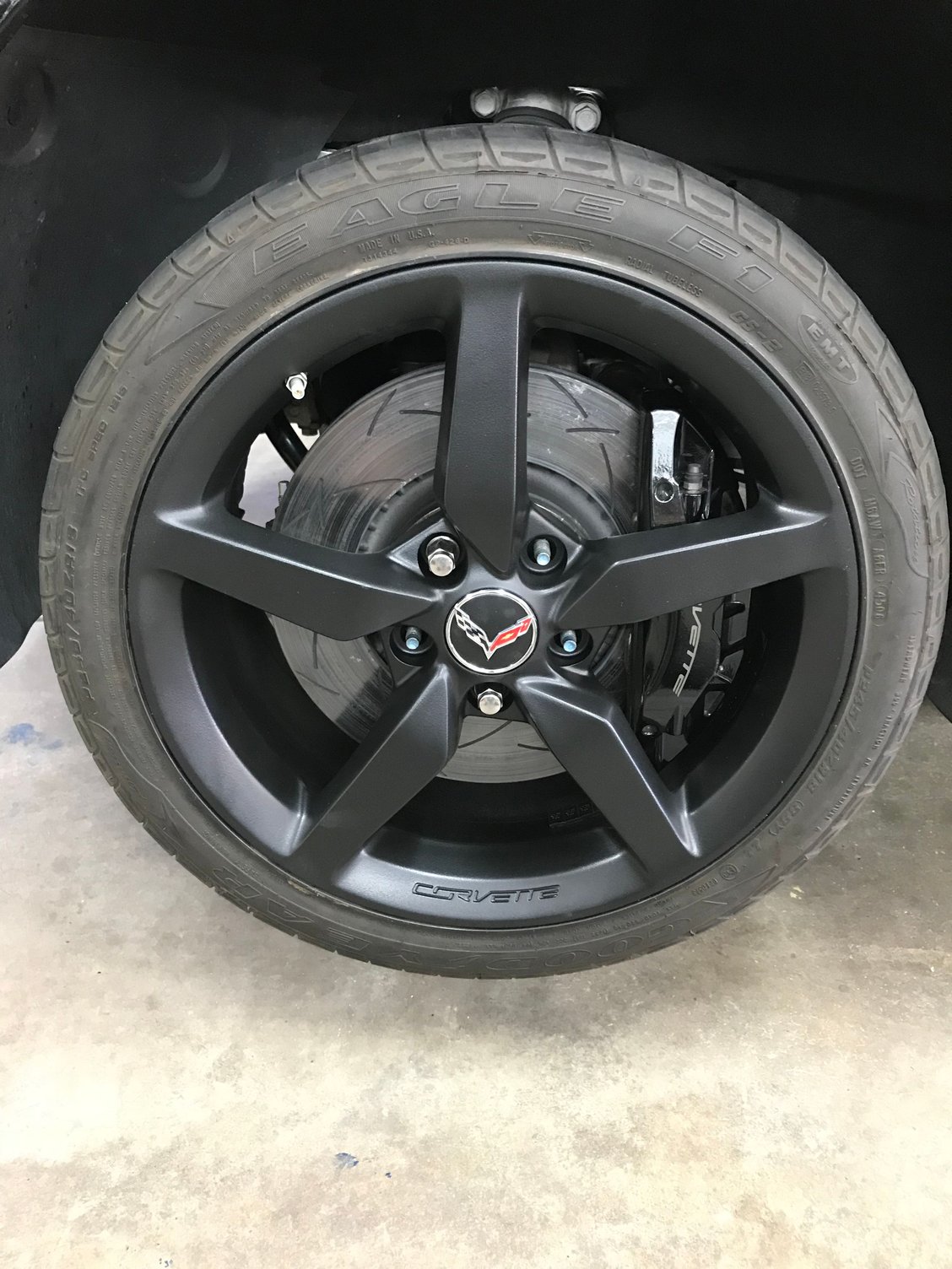

Sorry to thread jack... but just asking someone to confirm:
The stock front 18" wheels will fit over the 1" larger front Z51 rotors???
Since the rears rotors are the same size I assume they will easily clear the larger 19" wheels out back.
Just for the record I found this data in various other thread about rotor sizes...
FRONT:
12.6 = Base
13.6 = Z51
14.6 = GS & Z06
15.5 = Z07 (carbon)
REAR:
13.3 = Base
13.3 = Z51
14.4 = GS & Z06
15.3 = Z07 (carbon)
Kind of odd that base C7 has the larger rear brakes, I can only guess GM was trying to share parts with the Z51.
