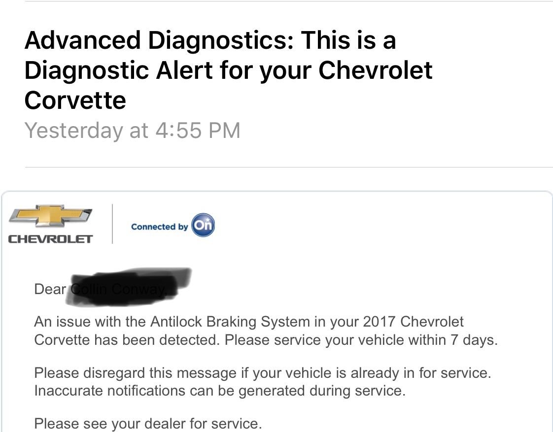

I had run a two day hpde event this weekend using new G-loc pads with R12 and R10 track compound- pre bedded. I had a great weekend and car performed very well with no fade and better initial bite. 2017 Grandsport with iron rotors, motul 600, michelin pilot super sport tires mostly worn. As I was leaving I got the above emails from onstar. Car didn't show any warning lights during track or after and car didnt enter ice mode, no abnormal pedal feel. Switched back to street pads since then and car drives normally. I'm assuming the higher friction pad compound made the wheel sensor send the computer a reading it considered to be outside of normal parameters. Should I have this looked into further or is it safe to ignore?

What does the code reader say?

Yes, you need to see what history codes are recorded. Need a scanner that can read ABS codes.

Did you change wheels? The reason that I'm asking is I got the same message once when I changed wheels. Since then I just manually paired the tpms sensors. Good luck.

If it had been the due to the TPMS sensors he would have seen a message on the DIC. When they aren't connected to the car's system that message is right there on the DIC and has to be reset so you can see all of the display. He needs to check for codes as that is the only way to find out where the problem area is located.

When mine did it I didn't see a message in the D I C. I did get a text message and an email though.
