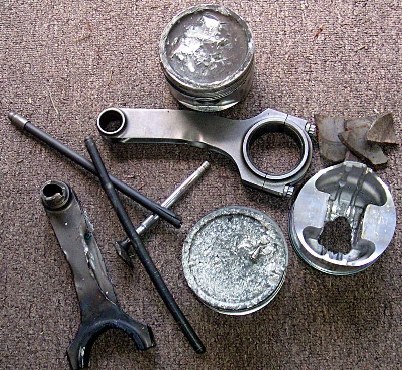

Sorry to hear it, but from my decades of blowing up parts on dynos and on the Salt Flats I'd say that you may never know what happened, but without looking at the pieces you sure won't. Welcome to the world of enhanced performance. S**t happens. I try to always tell anyone chasing more power no matter in what or by what means, there are always risks.
Here's but a small sample of what I'm talking about,

I think most of those are reusable
