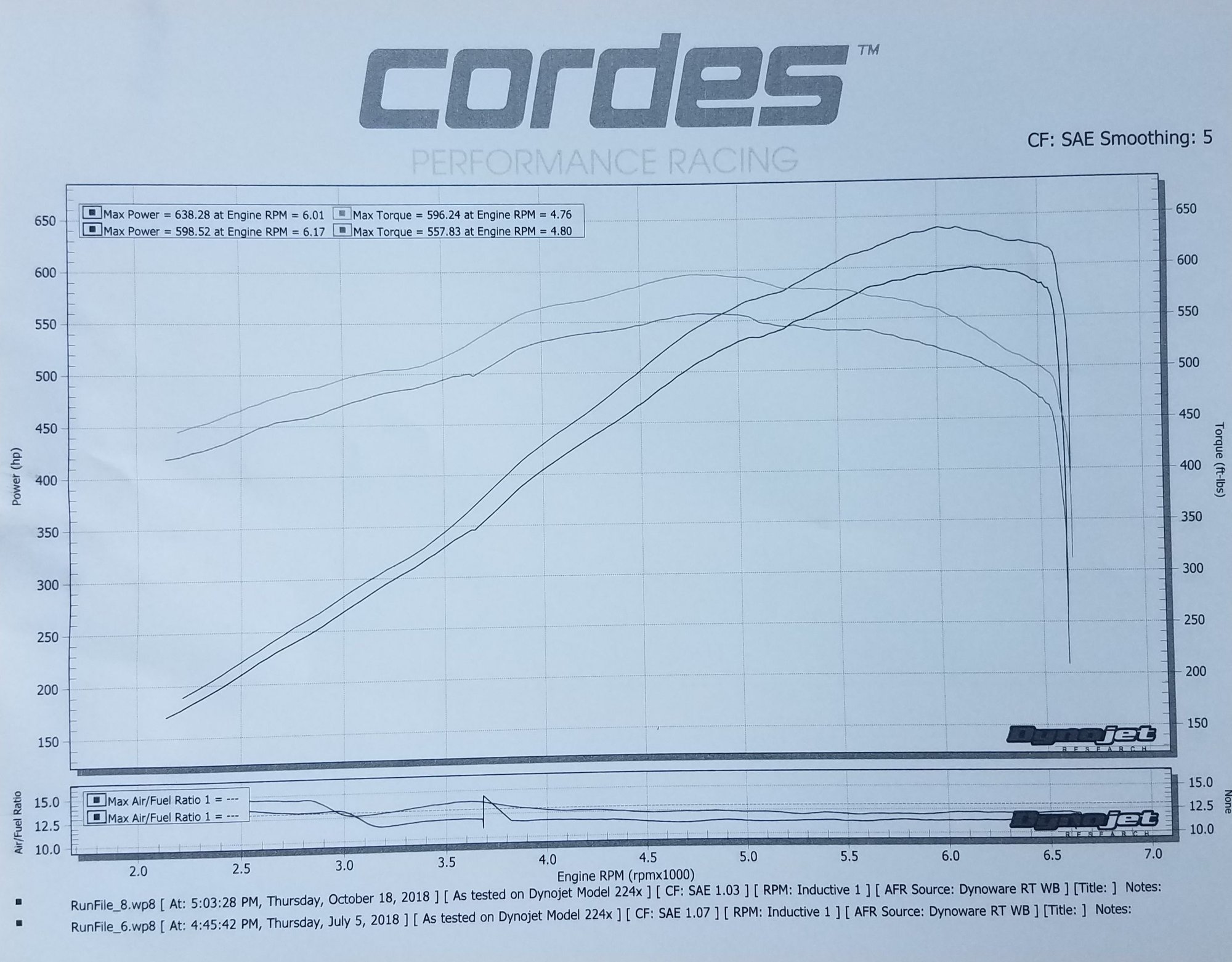

Self installed an LT4 HPFP. Got it for $615 on rockauto.com. I had Cordes Performance Racing update my tune and got an additional 38 rwhp and 39 ft-lb of wheel torque. Totally happy with that!
Thanks CPR and thanks Nick!
2016 Z51
A&A V3 Si with 3.8 inch pulley
Alky Meth injection single nozzle
Flex Fuel tuned at E64 (that's all there was)
LT4 HPFP
This is one fun car!

No other mods, just the hpfp and tune added 40whp?

Yes, BUT, my setup was fuel limited by the LT1 HPFP. So adding the LT4 HPFP just allowed me to get more fuel to get more power out of my setup.

Okay, that makes sense. I've always heard the LT1 is limited to around 630whp by its stock fuel system.

638hp! Excellent! Congrats!!

Nice results! However, I would think that if the gains were fuel related then they would only have shown up on the higher rpm and horsepower end of the graph where the stock pump was running out of fuel. The stock fuel pump should have been sufficient at the lower rpm/hp levels. The gap does increase linear but almost all stock vs tuned dyno results do this too. I assume due to percentage increases. Maybe it was just a superior tune? Either way that is good power.

I was thinking the same thing here but wasn't going to say it. Agree also on the rwhp # on the unit.. Robert

correct he has a higher ethanol %

Tuner was probably just running it real safe across the board knowing it would starve up top so that the car didn't fall flat on it's face up top and lean out.
