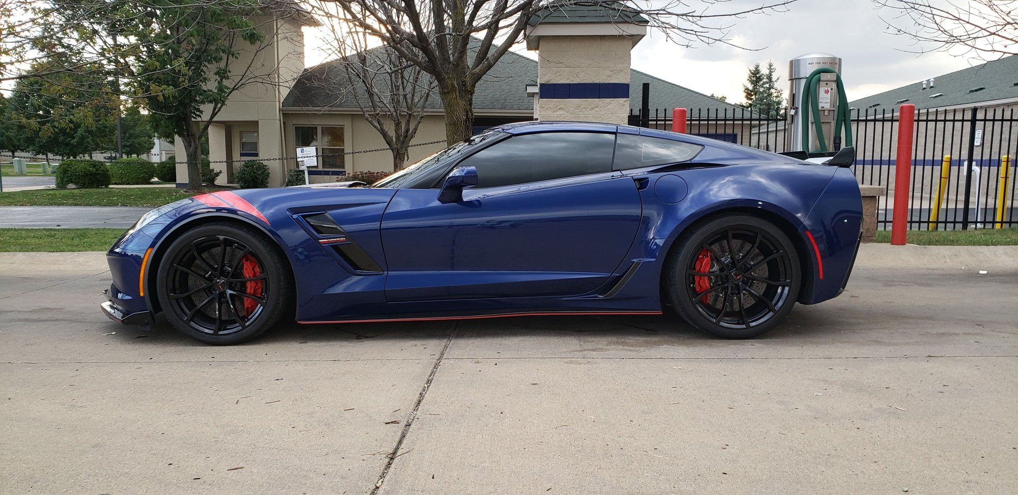

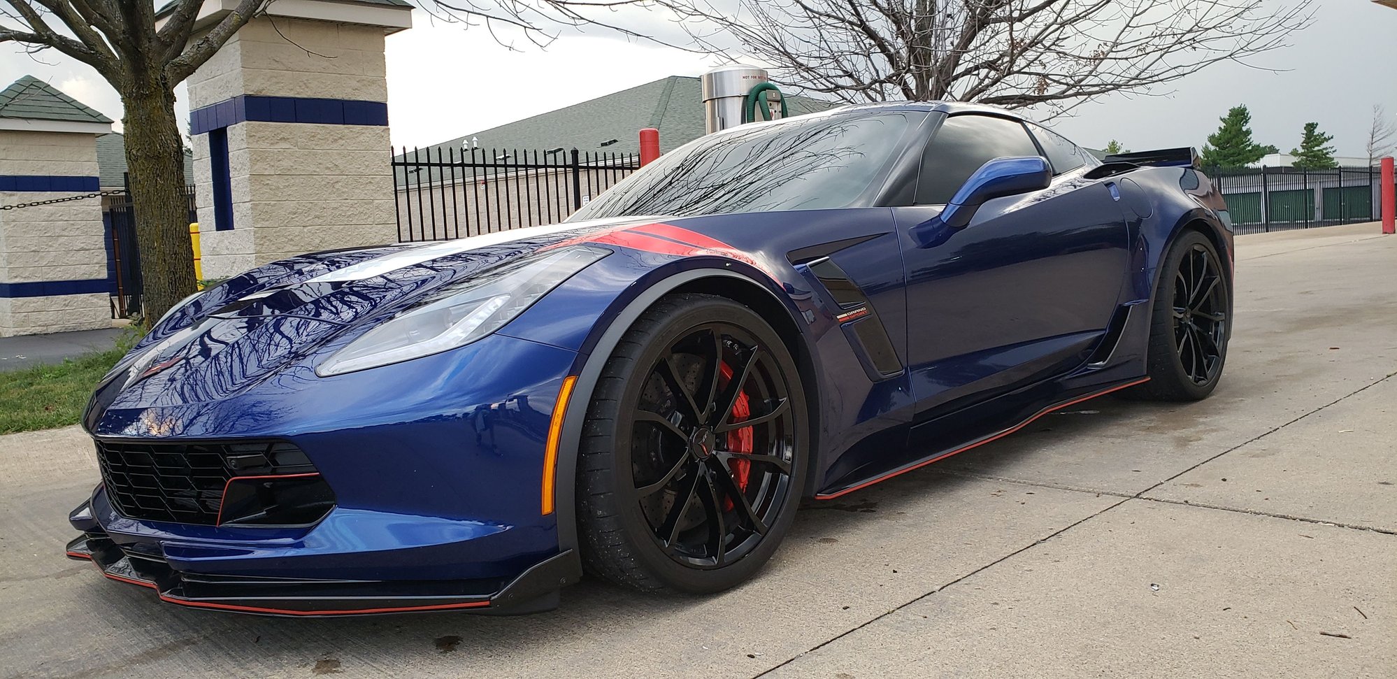

I lowered my GS Z07 on stock bolts but had to cut rear rubber stops to get the rear to try and level out with the front better. Looks much better than stock for sure.
