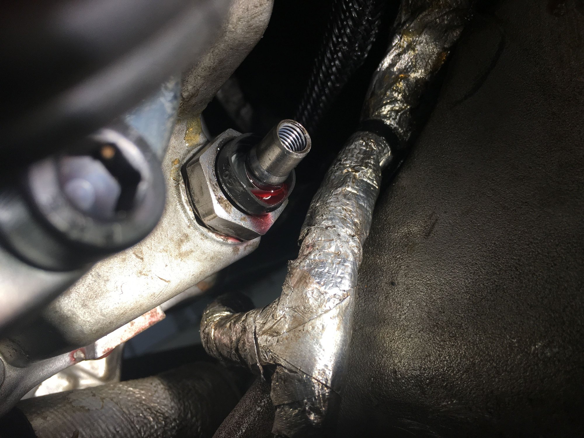

I had a driver side axle failure that resulted in damage to one of the fittings used to attach the eLSD hose to the differential. After a little research it appears this fitting only comes with the rear differential and cannot be purchaced separately. I’ve been looking for someone who may have one used but without much luck. Any ideas on where I can get this fitting without having to drop 3k on a new differential?

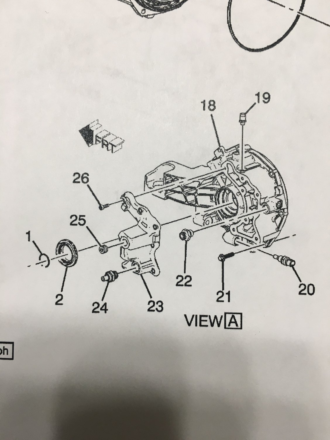

Here ya go. Appears all four of those dealers were mistaken.
024 - CONNECTOR. Differential Clutch $21.38
Part number: Part Number: 23154582
CONNECTOR,L/SLIP DIFF CLU PIPE(18MM THREAD).
Ant

This was very frustrating. I went to one local dealer and pointed to the part on the schematic and was told it only came with the diff. I then called two other locals and one out of state. One local game me a part number but when they sent me the picture it was a coolant line fitting. Then I had to deal with the dealer to bleed the eLSD system $280. The same one that told me the fitting wasn’t available.
