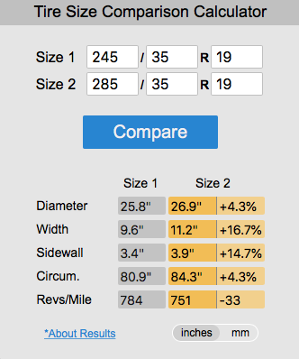

I have read a variety of threads/posts on the subject of the tire sizes and the fact that its necessary to maintain a difference between the front and the rear (rear larger) to keep the computer happy. Some indicate that the front must be a certain percentage of the rear... Or at least within a certain range.... Other threads indicate that as long as the rear tire is larger, then all is well.
My car started life as a ‘17 base model with the 18/19” set as below:
http://lh3.googleusercontent.com/-2X...o/IMG_0306.JPG
The factory provides for a rear tire that is 4.7% larger than the front.
I’ve gone with a BBK and 19” rims are necessary up front.... So at the moment, running the 19/19” equivalent to the factory setup:
http://lh3.googleusercontent.com/-05...o/IMG_0307.JPG
^^ Rear tire is 4.3% larger than the front.
So now I’m looking for a wider footprint up front... and examining options for my 2019 track season.... How low can I go on the percentage?
Say I decided to try the next logical step wider and simply up the front tire to the 265/35:
http://lh3.googleusercontent.com/-dt...o/IMG_0308.JPG
^^ Nearing a square setup with 265 front and 285 rear.... and the rear still 2.3% larger than the front in overal diameter. Is that enough for the computer to be “happy”?
What about if I went as far as 275:
http://lh3.googleusercontent.com/-o4...o/IMG_0309.JPG
275/285 and rear is 1.1% larger in overall diameter.
There are a ton of other variations - especially when considering changes to the rear tires too.... I’m just interested in the percentage between front and rear.... What’s permissible? Is there some magic ratio? Or is it “ok” as long as the rear is larger by a “smidge”?
What say the folks smarter than me?

Old Dec 20, 2018 | 10:25 AM
malexand123's Avatar
malexand123
Joined: Jul 2017
Posts: 222
Likes: 43
I suck at attachments apparently, so I'm doing the attachments from my original post above... Just makes it easier to see them instead of clicking and going to a new window.
Factory:
Current:
265/285:
275/285
