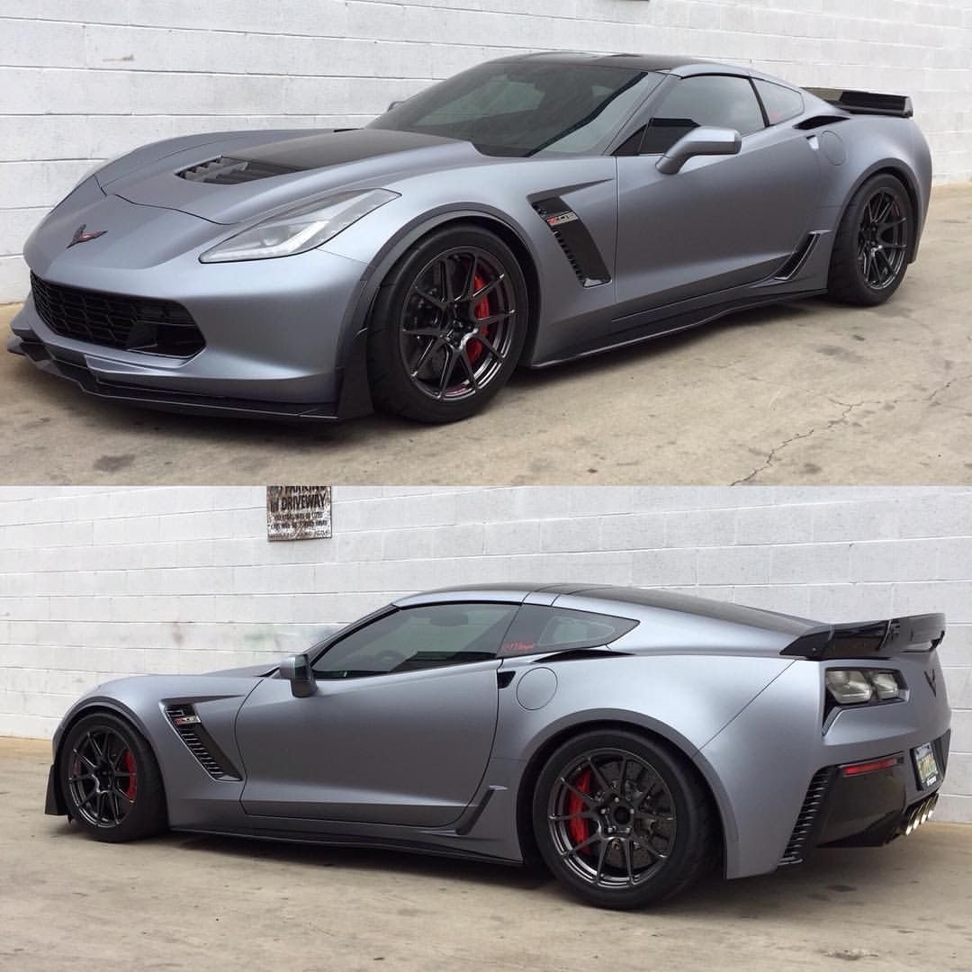

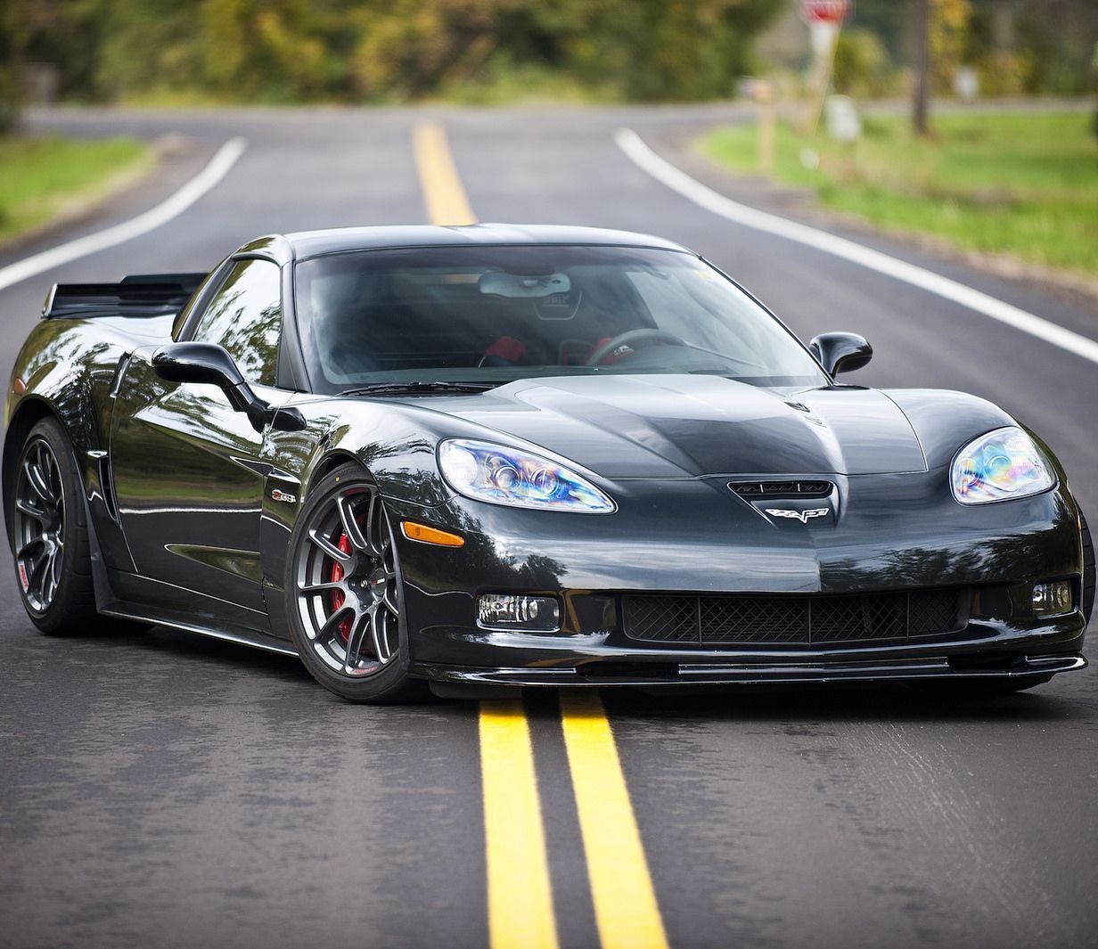

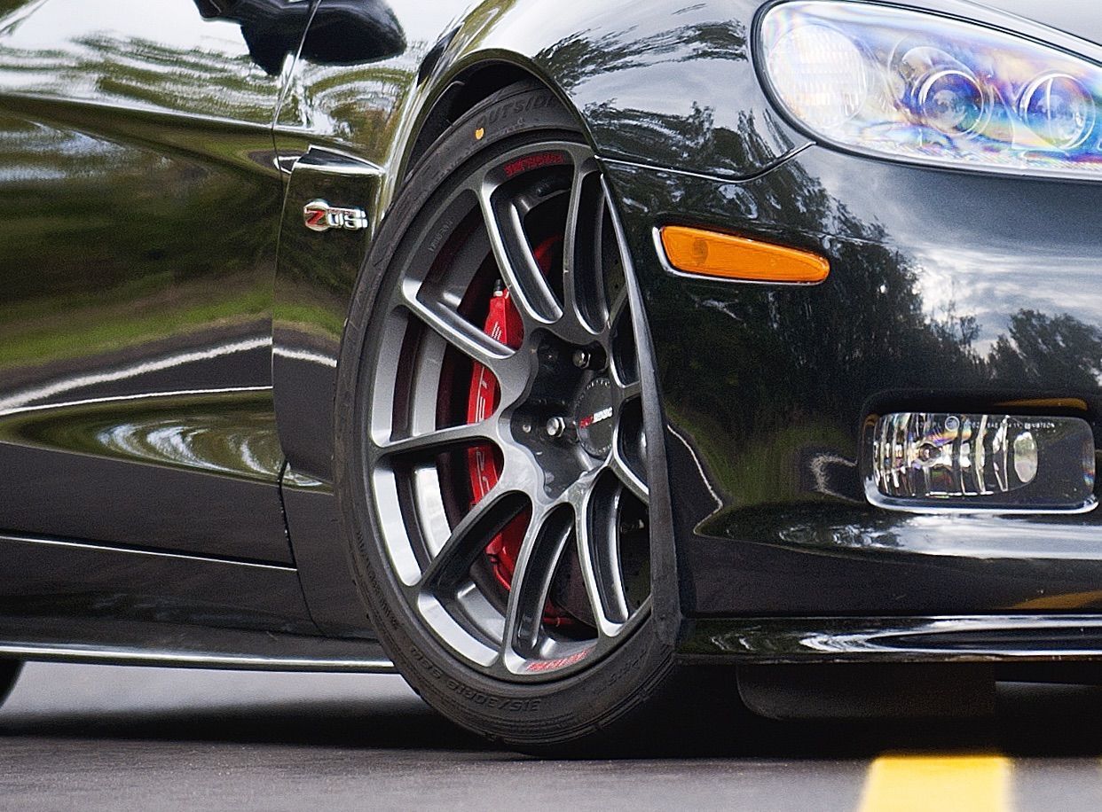

Give me a call anytime. Forgeline has 25 yrs in the racing and wheel game and make incredible Track Wheels that will stand up over time. All our racing wheels carry a 2100 lb load rating.
We provide Motorsport Pricing for all Vette Members on our Track Setups and made in the USA using the best APP forgings.
We can do 18/18 and clear CCCBs with Forgeline
-GS1R
-GA1R
-GTD1-5 lug open
-ZO1R
-GA3R

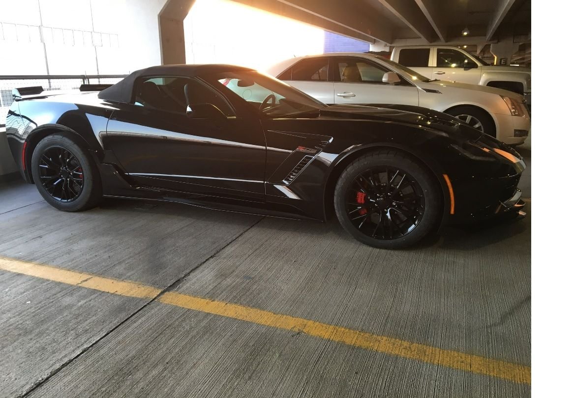

I just bought Z06 reproduction in 18 all around. I went a little wider in the rear though.

They are stock width and offset but in a 18" diameter. The rear tire is 10mm wider.
