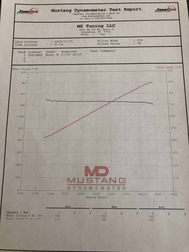

At the same time, the PD blowers are at peek boost as soon as you mash the pedal and they stay there throughout. When you look at the numbers at the same boost levels wirh the same cam, PD's make significantly more torque, period. You might say they "fall off", but even with the second car only running 10psi still over 600wtq at redline.
in reality the difference is seat of the pants. The torque hits right at the beginning and there is no letup...but there is also no building of boost as experienced with the centri.
for what it's worth, I have run the Vortech and 2 Prochargers, P1 qnd D1 on Vettes...so I completely get the different feel. But performance shows it to be a bit of a mirage.
Here are a couple samples of the PD blower torque curve when not using the anemic LT4 blower:

Another sample of the PD falloff...if by "fall off", you mean flat like a table.

Appreciate the dyno charts, but the the OP has a stock blower and that's what we're discussing simply falls off throughout the power band.
Also nobody is arguing a PD blower comes on hard and has somewhat of a flat torque curve, but it's a fact they do fall off compared to a centrifugal that will come in slower but continue to build power and torque for that gradual hold you in the seat feeling the OP was talking about.
i agree that the centri might provide the feel of building...but it is not reality. It's a feel. In reality, the feel is simply a function of running no boost, 2psi, 4psi, 6psi, and peaking at 10psi right before readline. With the PD, the power is all in right from the beginning (10psi from 2000-6500rpm's) and the area under the curve is a substantial advantage...to go with more torque at the same boost throughout.
The exact same is true with the stock LT4 blower. It just can't provide as much boost/power as the other more capable blowers. With the right cam, however, he should have a graph that looks just like the ones I have posted. I can probably grab some with the stock LT4 blower too.
Please note, I am not really arguing with you other than to say, the notion the torque of a PD falls off is fallacious (because at the same boost level the PD generates more torque everywhere in the band). The torque curve will definitely reflect the cam profile.
