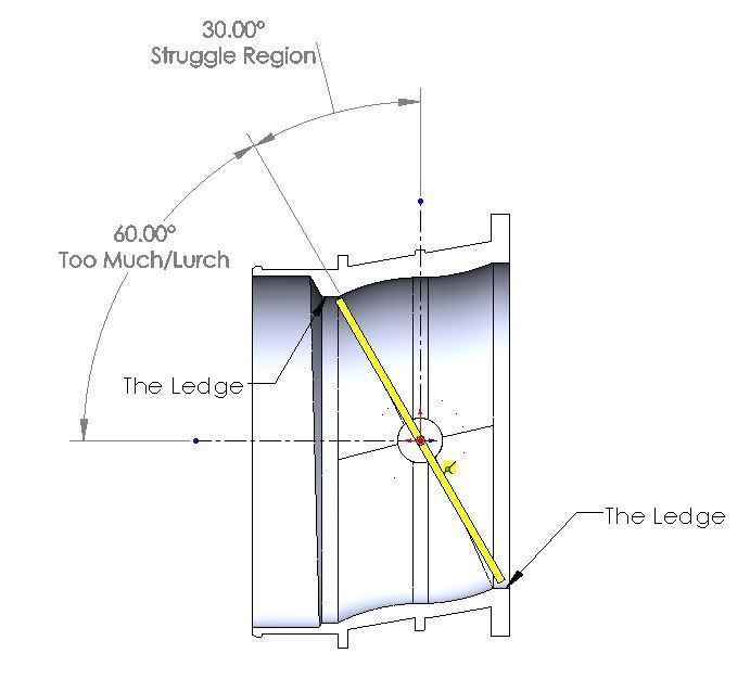

Andy, I can completely relate to that feeling. Basically, our C7's were designed to be very economic at part throttle (1.2 g/sec-deg throttle MAF response, this is a meager airflow rate/power you feel is not enough) and a track car at 1/2-full throttle (10 g/sec-deg throttle MAF response, "the lurch after the ledge"). It is very unpredictable. Visit our technical page for a better explanation. https://www.solerengineering.com/technical
I've added a picture of the OEM throttle body here in your own terms, not bad for a non-car person. You nailed it IMO.

Are you sure this illustration is accurate?
it seems there is no airflow until the blade is over 30 degrees.
Exactly, that is the OEM design. It is choked until that point. From idle up to 30 deg mass air flow increases at a meager rate of ~1.2 g/s-deg. Check our SE8223-100 Modified Throttle Body.
Old Mar 16, 2019 | 09:07 AM
RussM05's Avatar
RussM05
Joined: Jun 2012
Posts: 2,226
Likes: 1,029
From: Thomas Texas
I don’t agree with your analysis exactly as you stated above. It’s not chocked. It’s controlled at low throttle operation as it should be. I started a thread about this subject a couple of years ago and posted photos of both the stock and ported throttle bodies. See: https://www.corvetteforum.com/forums...post1592298998
To give the throttle a smooth response as you come off of idle, the GM engineers restricted air flow for the first ~20 degrees. The helps when you are pulling out the garage or around a parking lot.
I ported my throttle body and in the process totally removed the upper lip. Wrong thing to do as the amount of air delivery increase so dramatically off idle, the ECU pulled timing by 15 degrees. Then when RPM reached ~2800, the timing jumped instantly back to normal and the engine surged. The ECU monitors manifold vacuum and pulled timing assuming the engine was under load to prevent knock when you remove enough material in that throttle range.
From my experience, a ported throttle can lead to low speed drivability issues.
I scrapped that throttle body and bought one from Katech. Their first version and it also removed the upper lip. Same problem. I emailed Katech and explained what I had observed on my HP Tuners scan. They asked me to return it and was sent a new one which the upper lip was almost untouched. The car drove smoother and timing wasn’t being pulled. I still have the Katech ported throttle body on the car. But the stock throttle body is good.
in my view, the GM throttle body is a good design as-is to give good control as it comes off idle with this very powerful engine at low RPM.

From: South Alabama
I agree Russ, the OEM is a good design according to their goal. It shall fit many models (Trucks, SUV's, Cadies, Camaros), it should be fuel efficient at low to part throttle, and very aggressive at say >40% throttle. That is what they marketed, a track star that does nearly 30 mpg on the Hwy...and they truly did it.
It is choked, very, very choked. Measure/monitor your manifold pressure at part throttle, compare it to your local ambient pressure and you will see for yourself. The most important part is not that, it is the MAF rate of increase ~1.2 g/s-deg, monitor that and see results for yourself, you will land near that number at part throttle.
Completely removing the upper lip is a step too far to fix the problem. There is a certain amount that is adequate.
Yes, some PTB's can lead to low throttle drivability issues, we found that on four different brands of those, this is exactly why we designed our own.
If your taste and goals align w/ those of the OEM design, there is nothing wrong w/ that. I just wanted to offer a solution to the OP, who is concerned about "struggling at low throttle".
