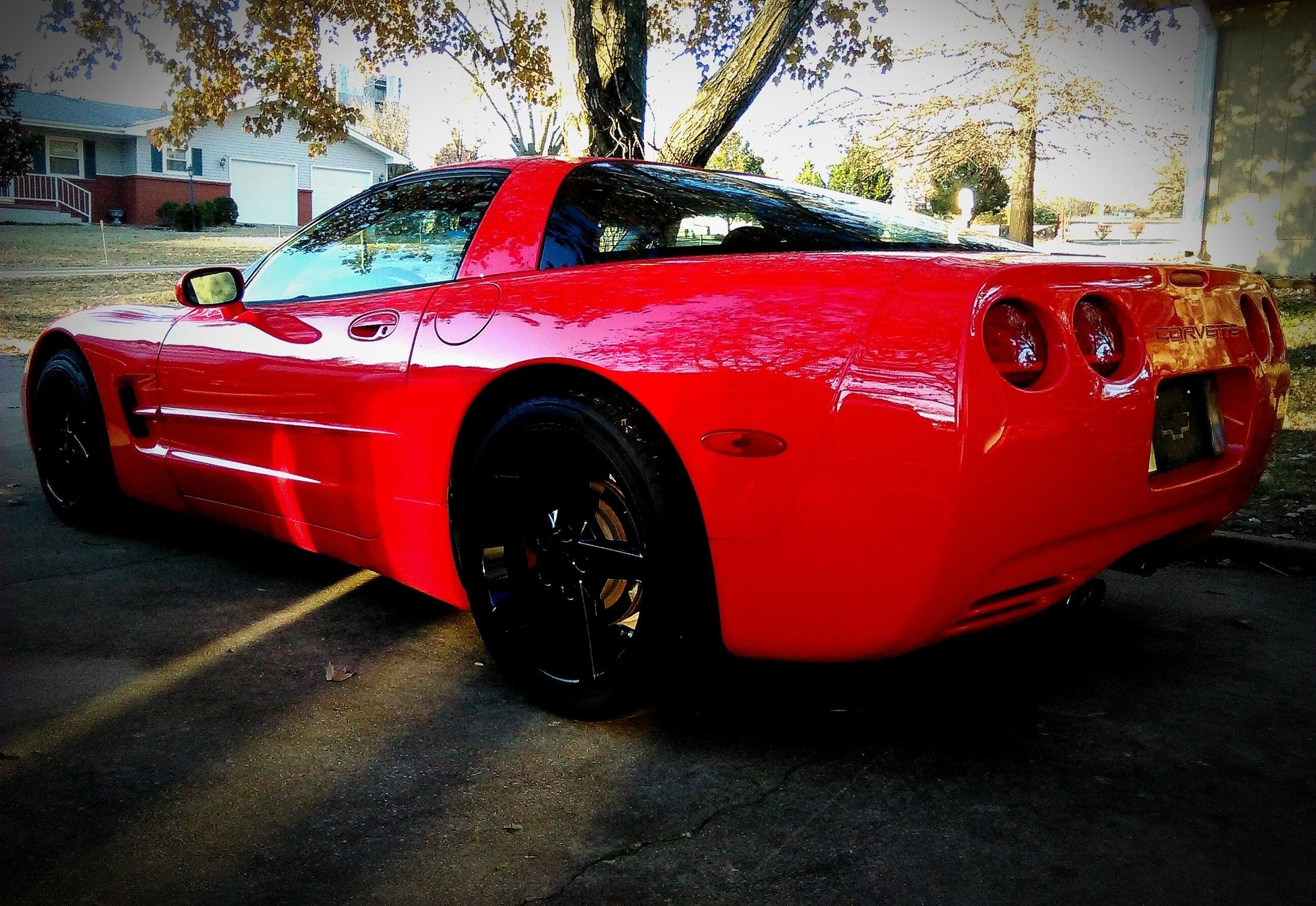

This isn't relevant to the OP's unfortunate problems he is experiencing (but from what he says, Chevy do seem to be trying to get it running as it should be)
but "as far as I know" from my 20yr old C5's history it has had zero break downs, several factory recalls, & just the usual fluids/filters replaced as well as brake pads & tires...............so not too bad for such an old girl!

That "Old girl" looks brand new. Nice job. I had a 2004 Z06 and I had zero issues with it. My 2019 GS has 4000 miles and so far so good.
