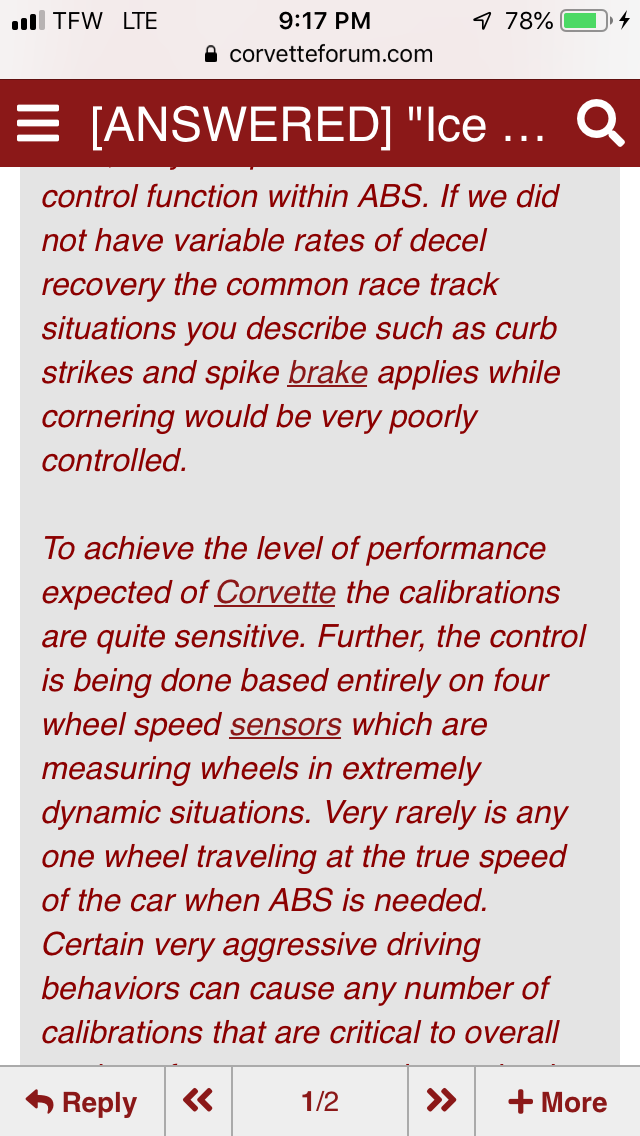

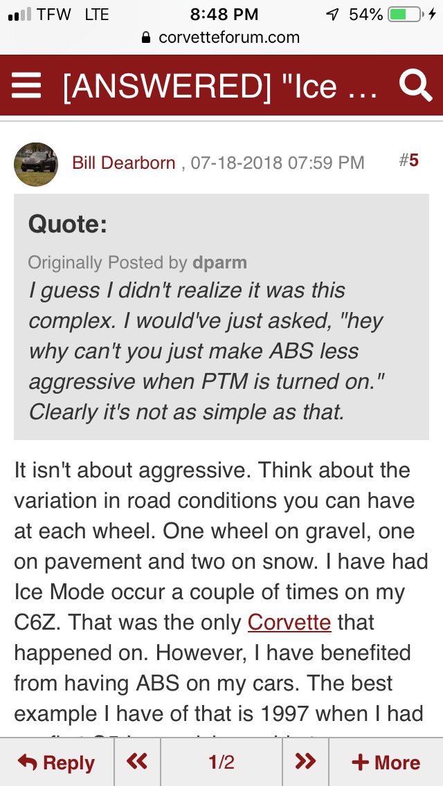

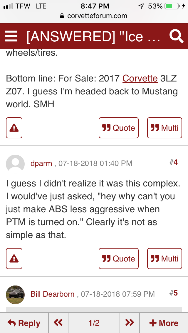

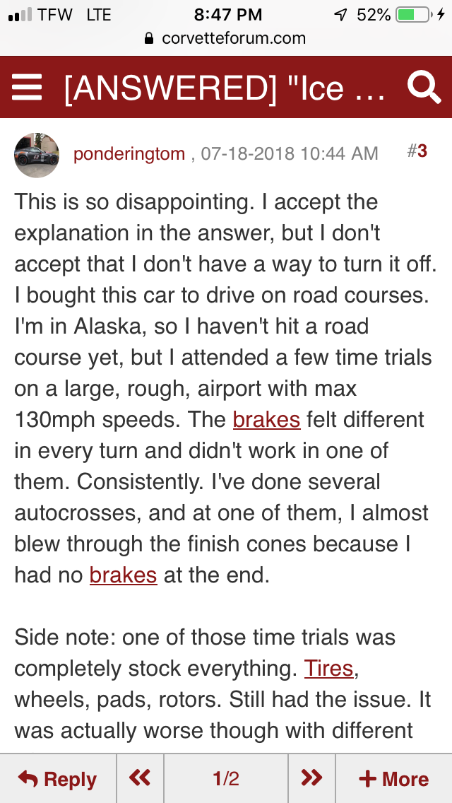

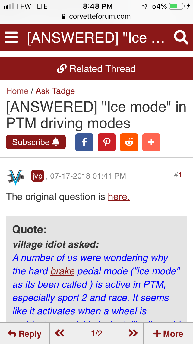

Old Feb 5, 2019 | 08:50 PM
savage's Avatar
savage
Joined: Jan 2014
Posts: 1,078
Likes: 262
From: swoyersville pa
Old Feb 5, 2019 | 08:51 PM
savage's Avatar
savage
Joined: Jan 2014
Posts: 1,078
Likes: 262
Wow !!!! Their is no fix for this !! Except hit the brakes softer!! Again wow !!!
