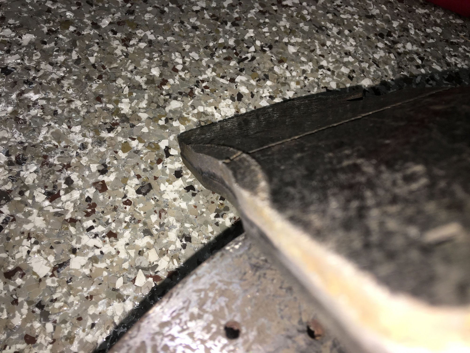

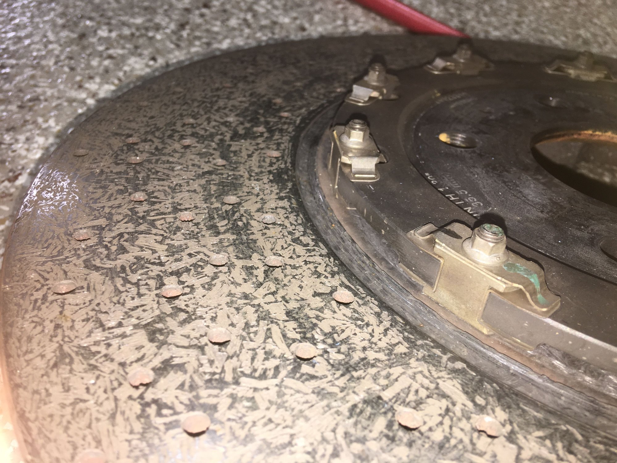

I had the stock CCMs on my car through several track days. Since the pads were wearing fast and were over $500 from Amazon I decided to try some XP10s for the front. The XP10s wore down just as fast but I think they accelerated the degradation of my rotors. First thing I noticed was the pad material was further inboard than the stock brakes although both sets of pads were using the same backing plate. After 6 track days I noticed a deep groove starting to form on the inboard portion of the rotor just outside of the rotor ring bolts. This groove was on both sides of both front rotors. I also noticed the rotors starting to pock mark which increases pad wear. That is when I switched back to stock pads but it was too late. Here are several pictures of my rotors when I replaced them. The groove is hard to see in the rotor due to the patterns of the rotor but the last picture shows what happened to the stock pad I used after the groove started. Notice the ridge on the pad. That ridge was on both pads at both front brakes. Carbotech indicates they don't think their pad caused the issue but I think the placement of the pad material on the backing plate caused it to rub on the rotor differently than the stock pad does.
If you go the Pagid web site you will see they make race pad compounds specifically to match CCM rotors. Maybe they are providing misleading info but I doubt it. http://www.pagidracing.com/en/produc...amily-rsc.html . As mentioned above these pads are expensive and run about 50% more than the cost of stock pads from Amazon. By the way the C6 ZR1 front pads will work well. The only thing different about them is the wear sensor wiring harness length which is too short for the C7. The C6 ZR1 rotors will work as well but they don't have the hole for the little bolt that holds the rotor to the hub. On my car those little bolts got so hot they froze in place and I had to drill them out to remove the rotors so I could weigh them.
Bill
My friend had the same problem with the stock pads. I think that's more of a "the rotor is worn and chewing up pads and ready to go" than anything.
