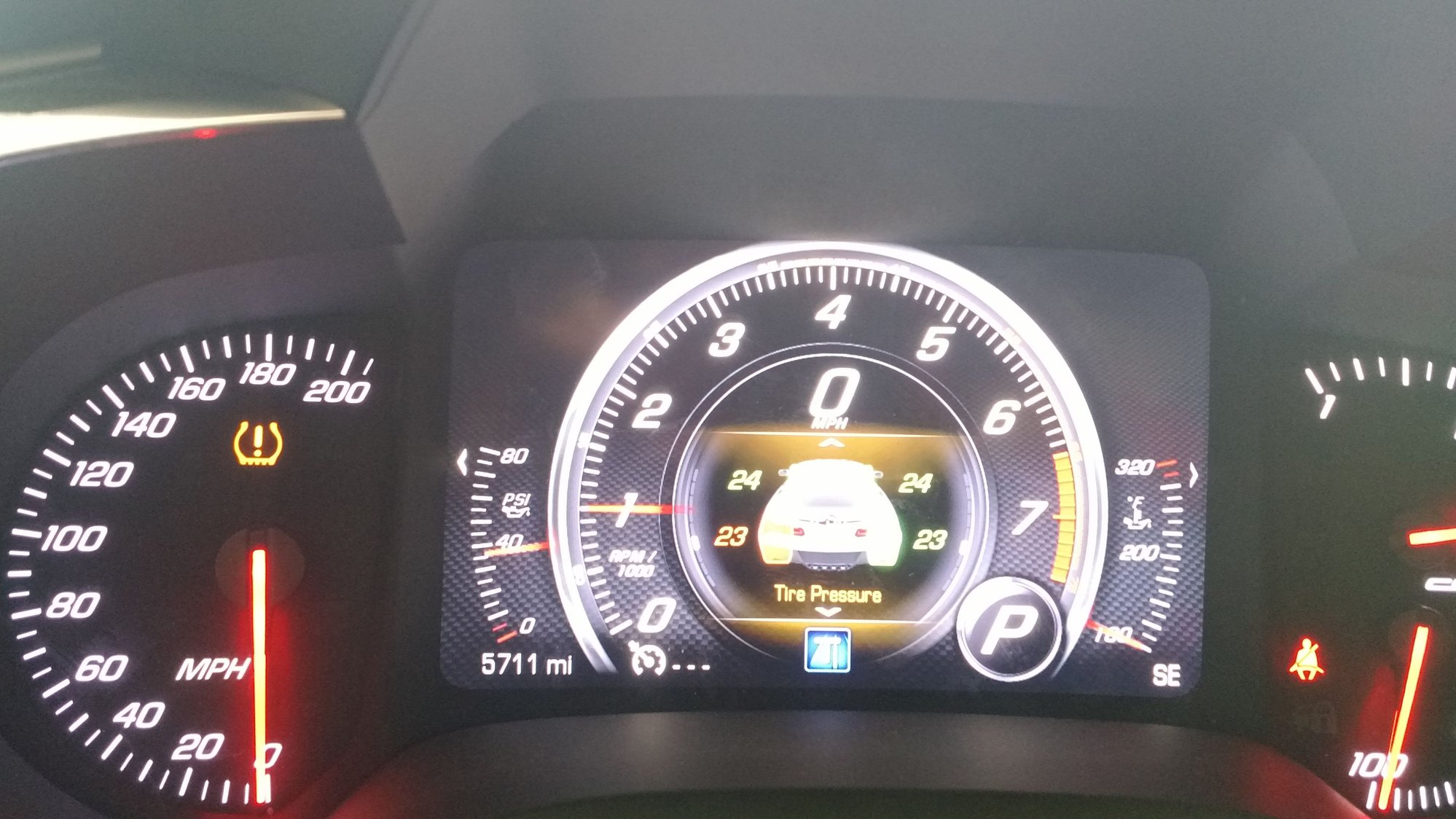

Weird situation? I took the car out for a run yesterday after sitting for a couple of months (winter) Received an alert on the DIC of low tire pressure,(happened as soon as I stared the car) checked all pressures and they were fine. I thought maybe run it for a bit and see if it works itself out. Nope...
Does any one know how to reset the sensors, short of taking it in? Yes I also checked my manual pressure gauge(s) , I tried 3 different ones and they all had same readings. Any suggestions will be appreciated.

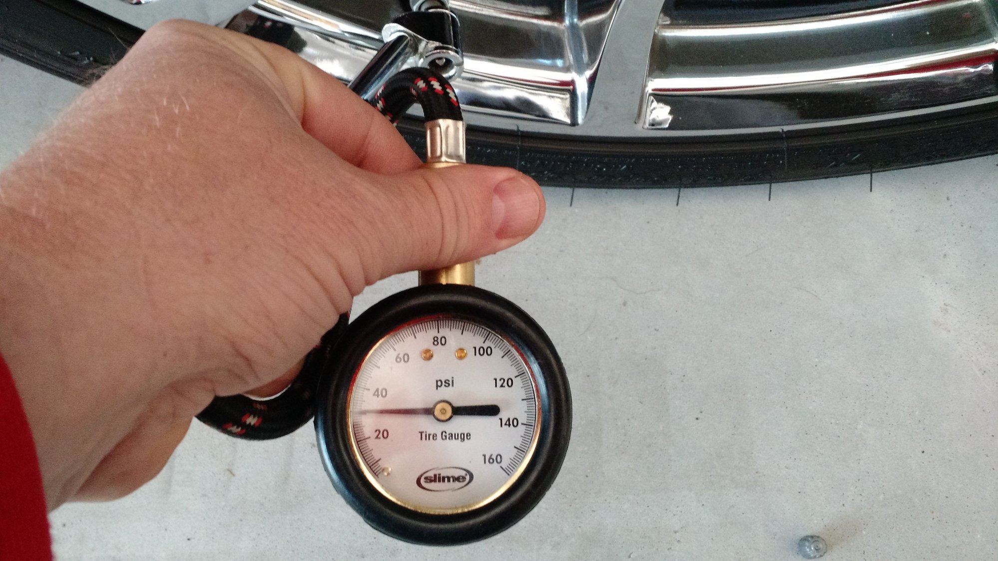

Re-checked all tires again today,
Tires were reading 35 on all 4 tires on the mechanical gauge,(pictured) and the hand help Ryobi hand held air compressor. Car readout (DIC) stated 25 in all 4 tires when started car. Went out for 1/2 hour ride, when got back tires showed 26 on fronts, 27 on rears. No warning notices. rechecked w/Mechanical and showed no noticeable difference.
I have it scheduled for an oil change next week, will mention to dealership and see what they say.
My question is: If the car is reading the low pressure for the tires on most cars and people don't check it w/gauge (assuming gauge is correct) could this be the reason for bending wheels, over inflated and making things too stiff??? Hmmmmmm?
You're the only one who's had this problem as far as we know. And no one fills tires blind. Usually the tire pump has a pressure gauge.
