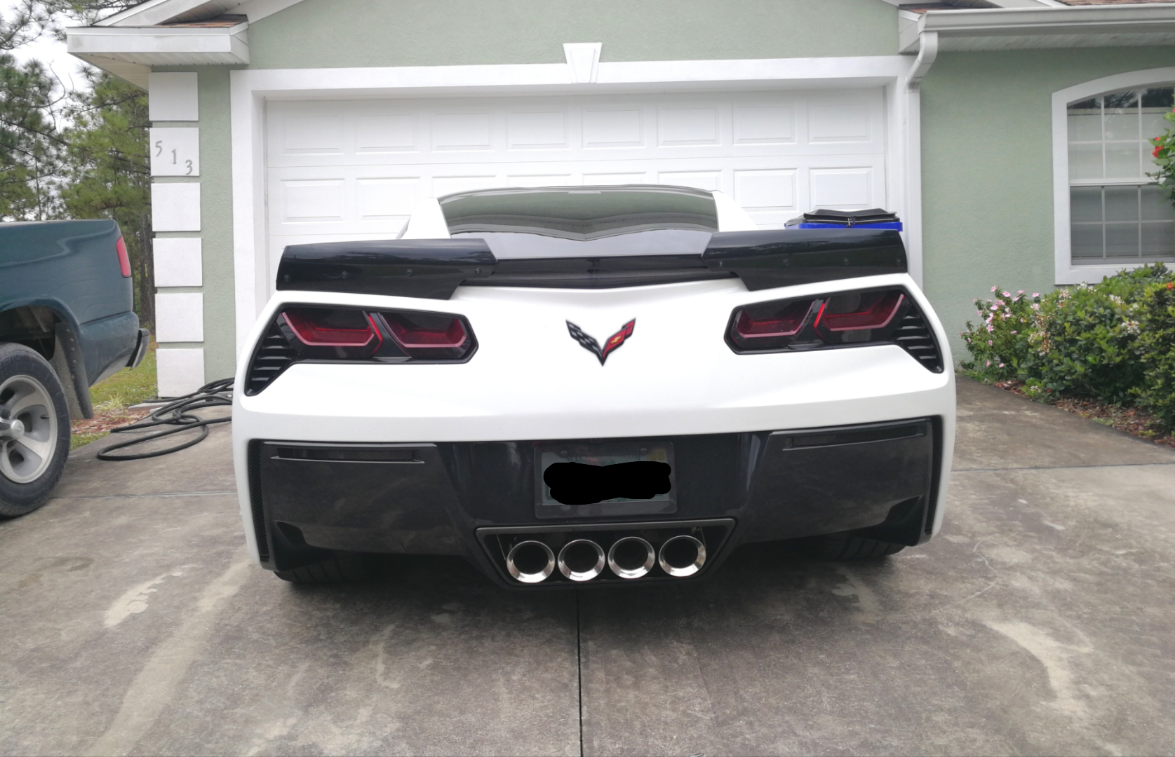

The easiest way is to just buy the GM wicker bills and drill holes in your stock spoiler. Insert some rivnuts and attach it. That's what I just did a couple weeks ago to mine. Super easy install.

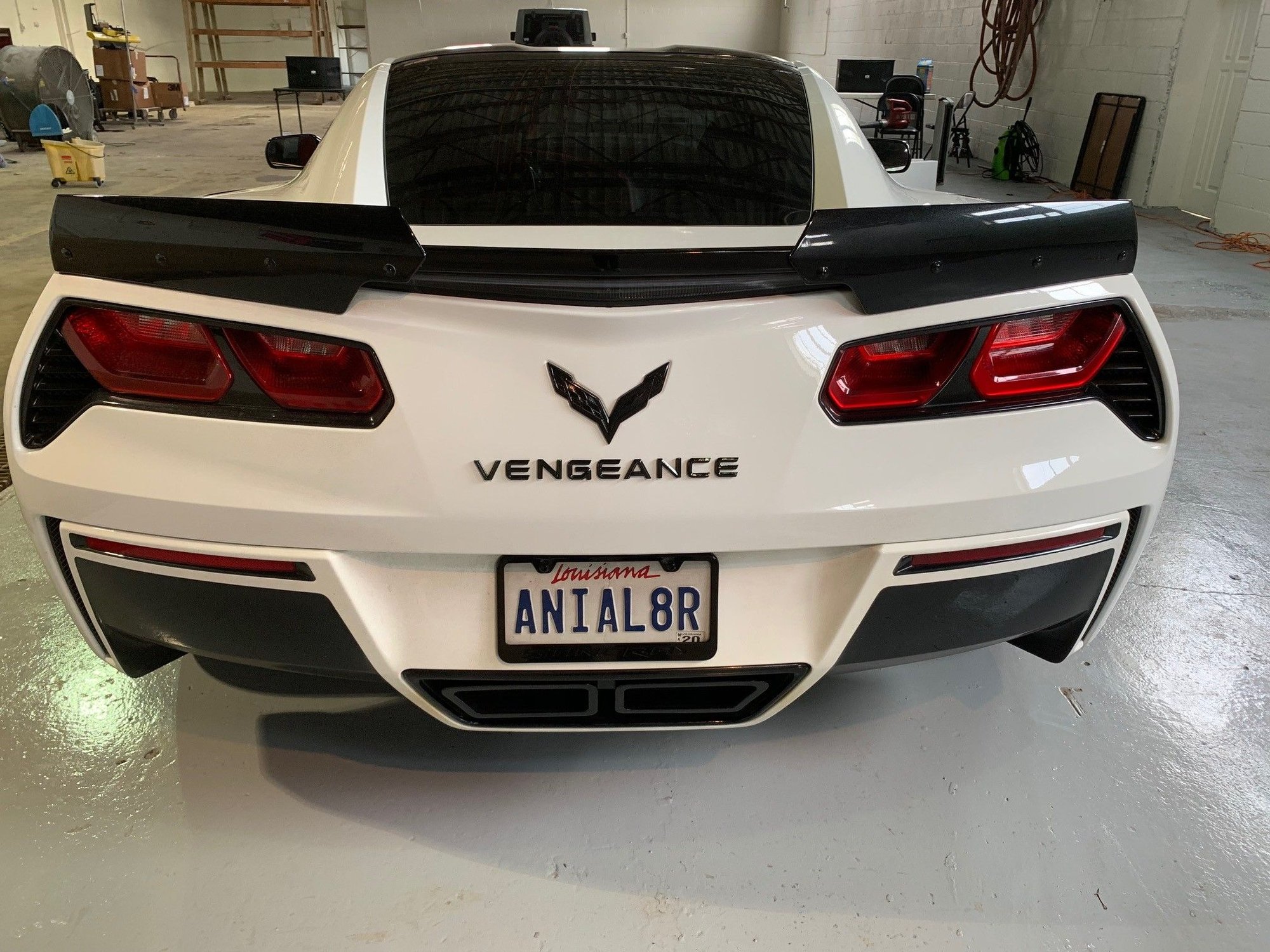

[QUOTE=LuisZ51;1599125670]The easiest way is to just buy the GM wicker bills and drill holes in your stock spoiler. Insert some rivnuts and attach it. That's what I just did a couple weeks ago to mine. Super easy install.
Same thing here....

[QUOTE=RossDowningChevrolet;1599127442]
Same thing here....
Details on what's going on with that diffuser immediately please? I really like that!

[QUOTE=LuisZ51;1599127500]
Just paint. Gives it a little more 'exotic' look (i think), and matches the Speedway exhaust tips nicer.

[QUOTE=RossDowningChevrolet;1599127539]
Very nice! I think I might have just found my next project.
