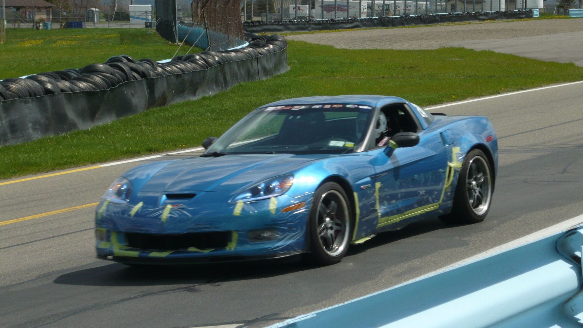

lol here's my version.. Paint tape for the paint and electric black tape for the carbon parts. Cheap, works and removed in 5 minutes!

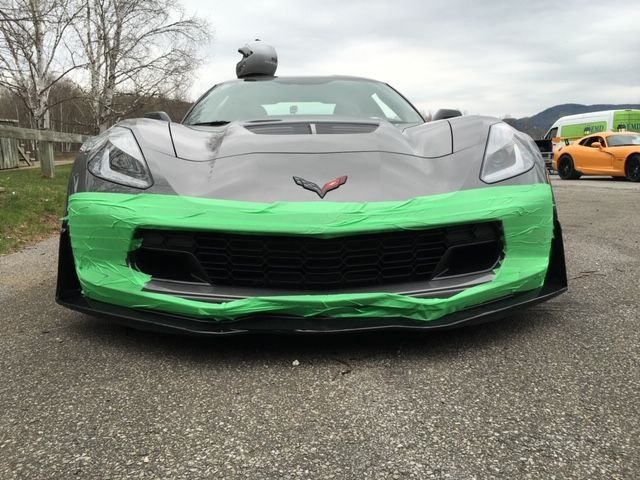

A low cost option is the use of Collision Wrap. It comes in several different sizes and before I put Expel on my C7 I used it on my C6Z. I used the 18 inch by 100 ft long roll which would cover the car for a season. Cost $50 for a roll shipped to the house. Once laid on the car I used the Scotch 233+ green two inch autobody painters tape to cover the seams/edges. Worked great, easy on and even easier off especially if pulled off right after last session of the event while the car and its body was still hot.
