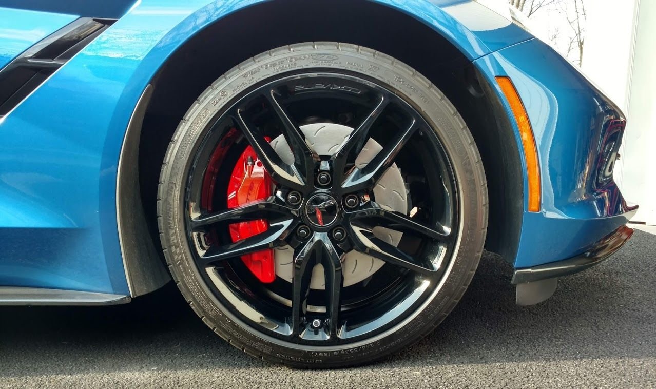

Power Stop Pads will turn your rotors Brown. And i am not the only one that had the problem just Google it Their tech support was hard to talk to and when i did they said it was Rust. I have Carbotech now. They do cost more and are made in the USA not China.
Now with Carbotech pads
