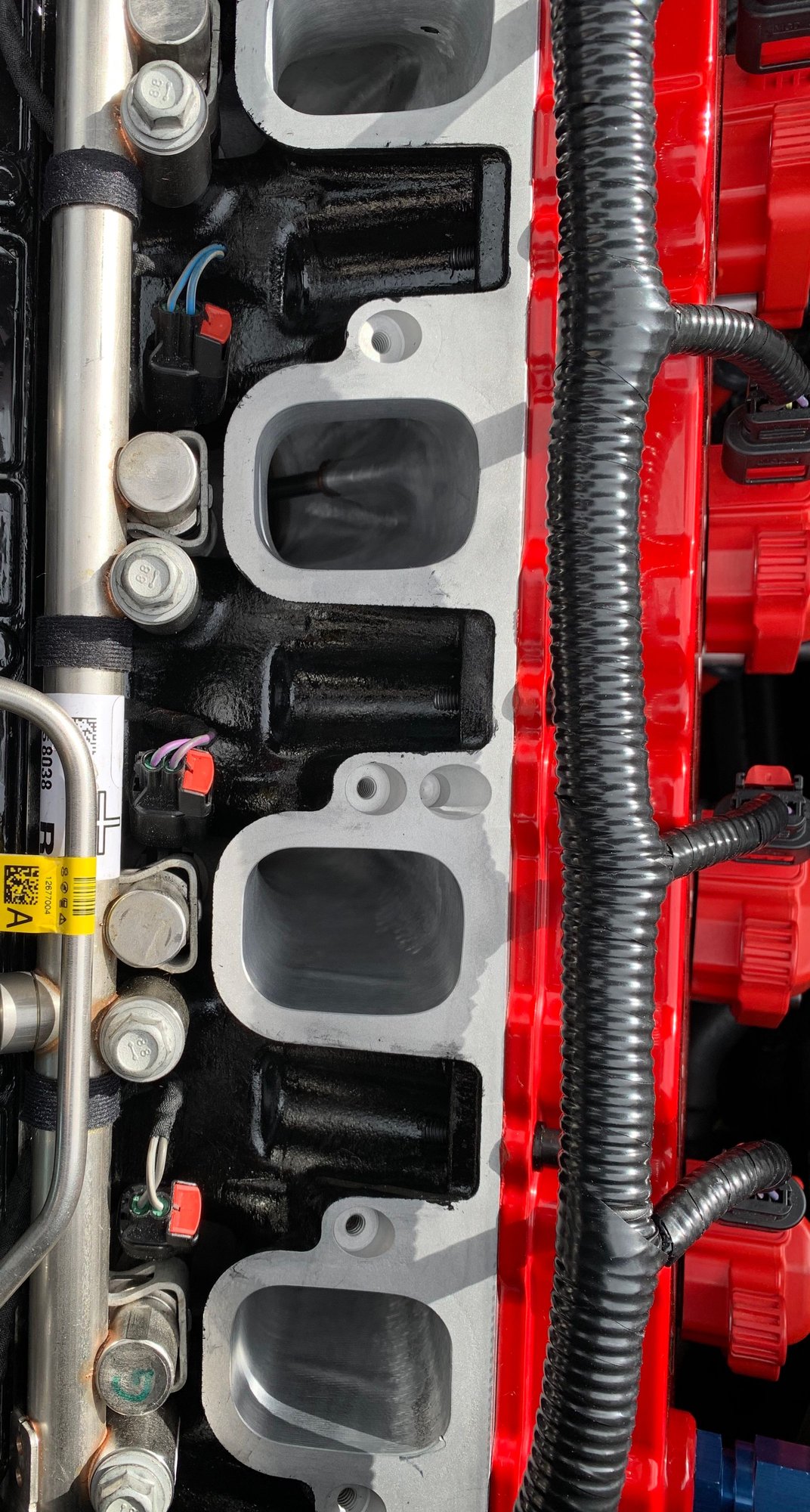

I've just finished installing new ported heads on my LT1 which meant draining the coolant and disconnecting the fuel rails (among many other things!). The car has also been out of action for about a month (sadly with a full tank of gas).

Gas and oil are unaffected. No different than the car just sitting around. Burping coolant may take a few times. There is a procedure in the book regarding getting the proper level. Not as simple as it used to be since the coolant tank is multi chambered.

Gladly
Fuel
Devilsown Methanol injection hardware w/ Alky Control Controller.
Dual 640cc/min methanol nozzles (Pre-T/B)
Single 320cc/min methanol nozzle (Pre-S/C)
LT4 HPFP
LT4 Injectors
MTI Secondary Low-Side Fuel Pump System
FIC 1000cc secondary fuel injectors
G1pro billet fuel rails
Crawford Racing secondary fuel system controller ( not yet installed)
Air
Procharger D1-X Supercharger (21 PSI) w/ Griptec 3.5” Pulley
AirAid 6” Trackday Air Filter
G1Pro long runner sheet metal intake (Ceramic coated)
LT5 Ported 95mm TB
Weapon-X 365cfm Ported Cylinder Headers with 10.7:1 CR
Tial Q 50mm BOV
Spark
MSD Ignition Blaster Coilpacks
MSD 2-Step controller (hard wired)
GMPP Spark Wires
GM Ceramic Coated Spark Plug Boots
Brisk Racing RR12S Spark Plugs w/ 0.025” gap
Rotating
Vengeance Racing Forged Pistons
Vengeance Racing Stage 3 Camshaft (+32% fuel lobe)
Brian Tooley Racing Dual Valve Spring kit w/ Titanium Retainers
Vengeance Racing Hardened Pushrods
C5R Reinforced Timing Chain
Brass Bushed Rocker Arm Trunions
LS7 Lifters
ARP Engine Studs
SacCityCorvette Billet Oil Diverter Barbell
Uprated Main Seals
LT4 MLS Head Gaskets
Exhaust
Kooks Decat Ceramic Coated Headers (2” Primaries)
Kooks 3” Decat x-pipe
ARP Header studs
OEM axleback with exhaust valves.
Other
Monster Triple Plate Clutch
Mighty Mouse Catch Can
WeaponX Valve Covers
Red Silicone radiator hoses
AMP billet thermostat housing with 160deg thermostat.
