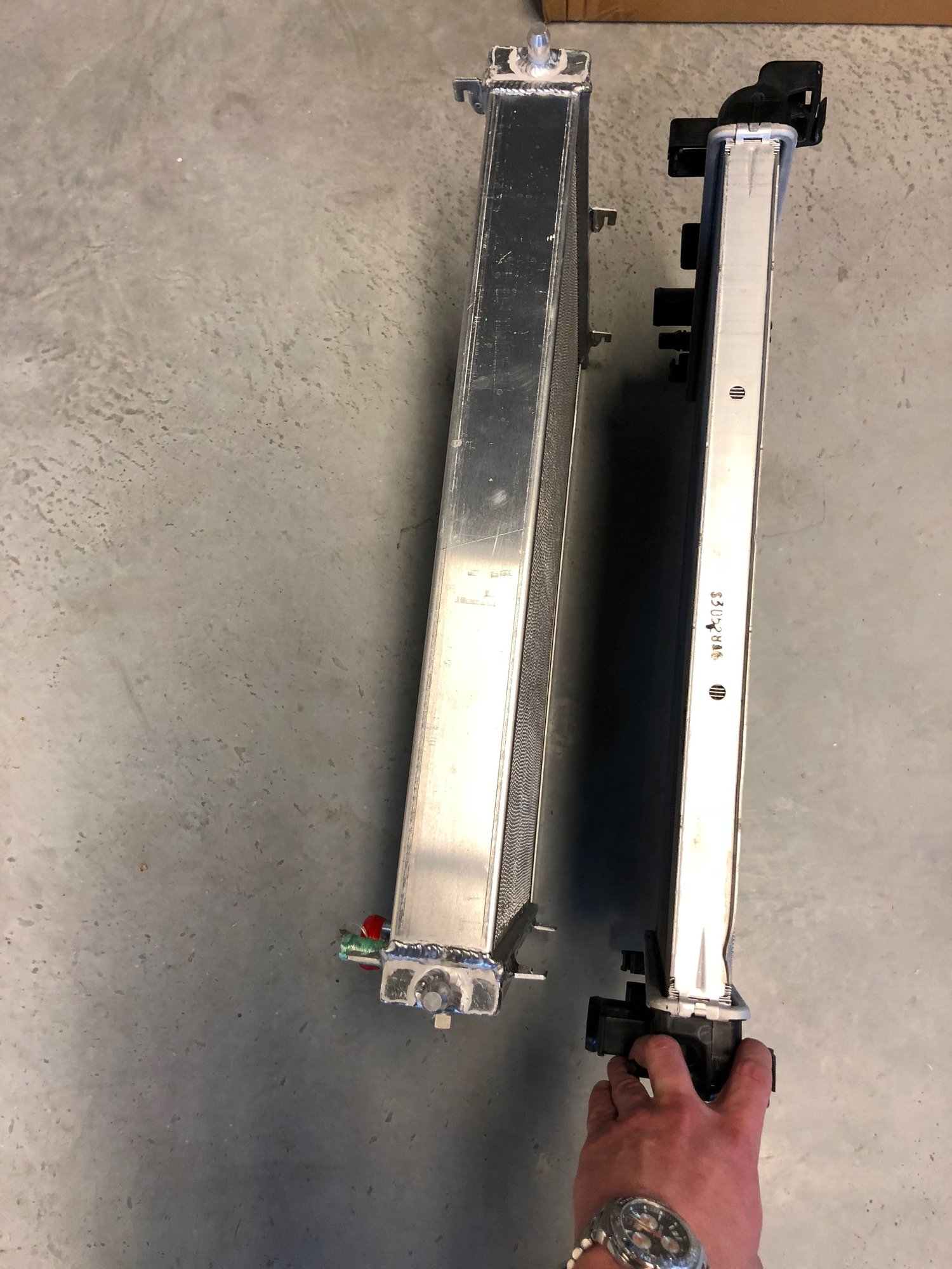

No need to remove any A/C lines. Taking the hood off would make it easier until you had to realign your hood afterward. Our Radiator would definitely help, it's all aluminum and way thicker than the factory.

Dewitt's makes a great radiator with great fitment. We went a little larger on ours so you will have to trim a little plastic piece on the bottom to get it to sit in there (link to the instructions). I can't really comment on the triple pass other than Matt is a friend of ours and he wouldn't put a crappy product out there. As to the oil cooler, the root issue of the Z06 is that the supercharger heat exchanger sits right in front of the radiator compromising its efficiency and I'm a little hesitate to recommend putting another cooler out in front of that area for a street car. An expansion tank/radiator combo may be a little better option for what you're doing with the car.
