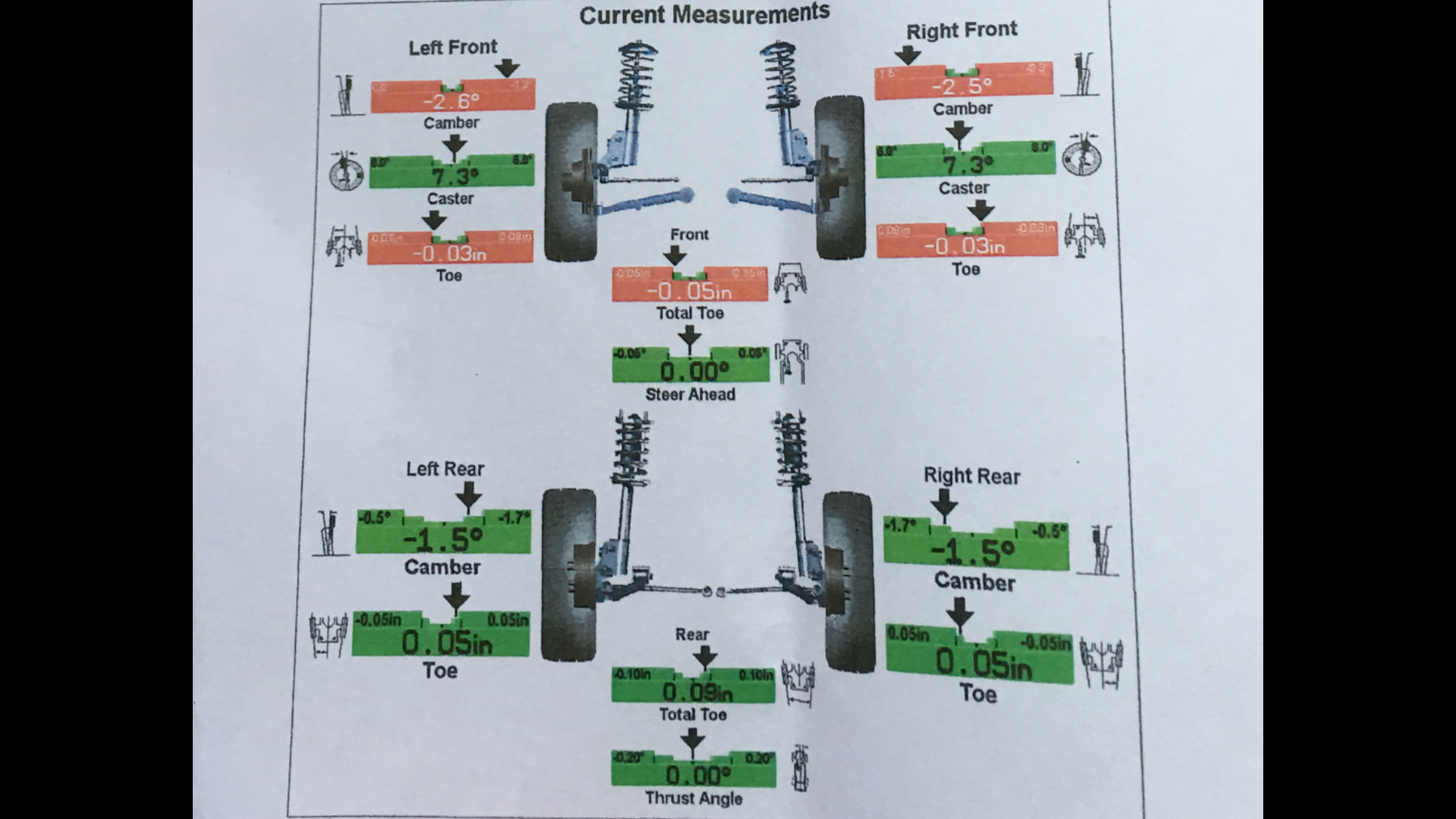

I pretty much only use my Z06 for track use now. Only street driving may be less than 200 miles a year. I'd like to get the best alignment for track only use. I've seen the discussions on the DSC alignment, and will use that, unless I get better responses here. So my question, the GM recommended toe alignment states: "Toe: 0.05 degrees toe in", however the DSC guide states: -0.5mm, are those basically the same?
Also, on the DSC guide, it states to remove washers on the TRACK/STREET settings, but not for FULL TRACK, any reason why?

DSC is not set up for pure track. It’s a street handling set up really. This is what I was running with slicks. Car was amazing at the limit! I could oversteer with precision at 120 mph exiting the sweeper at Buttonwillow with no TC!

DSC actually recommends toe OUT at rear, which is crazy for most, including me. I opted to have a very slight toe in instead.
My settings are:
(Camber / caster / toe; degrees)
Front: -3 / 7.9 / 0
Rear: -2 / 0.8 / 0.05
GM track prep already recommends -2 front and -2 rear camber. Many found better performance with more front camber, including me. It also helps increase the front tire life by supporting them better in sharp turn-ins.

I ran toe out with 2.0/1.7 in my z51 and I hated it. Any slight bump on the highway and it was really scary. Also due to the shitty DSC calibration for z51s.
I moved to -2.0 / -2.0 with 295/305s and that was great rotation, great balance.
On my new z06 I'm shooting for -2.2 front and -2 rear with 315/335s.. will adjust from there.
It is still a primarily street driven car though. So I don't want to wear out the insides to and from Track. Even with -2/-2 I was wearing the insides of my track tires just from driving to and from.
