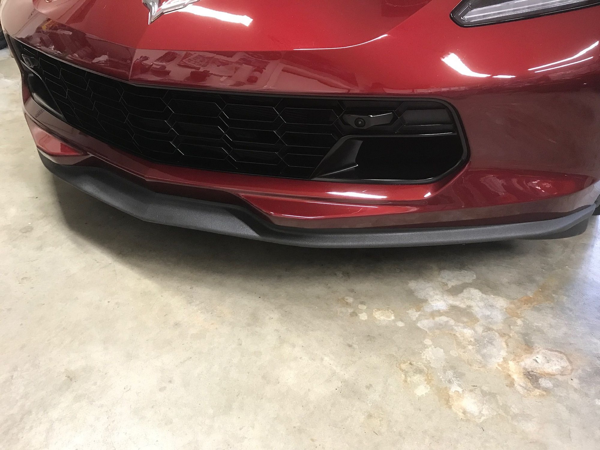

I bought at least 6 carbon fiber splitters for my lowered C6 GS. I could not stop smashing parking blocks. I was so stoked when my new C7 rarely bottomed out. I’m hell bent on NOT covering the car in carbon fiber. I have the plain black plastic splitter in front. Well, I still keep hitting **** even though I have these wonderful cameras. My splitter had 3 bad gouges in 3 areas. I took it off and sanded down all the rough spots. Here’s the good part. I hit it with truck bed covering. With two carefully sprayed coats, you can not tell it isn’t just a new splitter. It’s perfect. If I bang it up again, I can mask everything off and do a touch up. Am I the only one who smacks that sucker regularly?

This is after the truck bed spatter paint. Looks like plastic.
