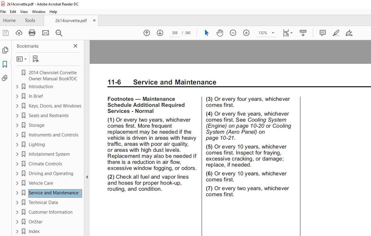

2014 Maintenance Service Intervals I have the eLSD
Elmer
Last edited by eboggs_jkvl; Aug 10, 2019 at 01:45 PM. Reason: Added another page of the Owner's Manual

Thanks for posting the table, Elmer, but can you also post the time intervals? It that in the footnotes? For instance isn't coolant 5 years Or.... Brake fluid 3 years or... etc. Most of us hit the time limits before the miles. I can also just look in the manual...
Elmer
Check my original post again. I added page 2 for the less ambitious folks on the forum.
Elmer
