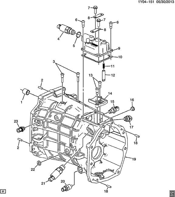

I've had trouble getting into reverse before so hopefully mine keeps working. I test drove a C7 that was nearly impossible to get into reverse, no way I was buying that one. A solenoid should be an on/off type deal but I wonder if it could occasionally get hung up or stuck. For your sake I hope its OK because to reach it you have to pull the transmission.
In the diagram below I believe its part #9...

I believe you meant item #4. Also, there is a special tool available which makes it possible to remove the solenoid after lowering the drive train a bit.
