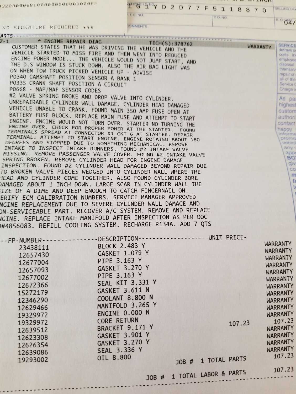

I went through the same fight as my motor dropped a valve, trying to start it fried my starter and the 350 amp fuse , was told that I shorted it by trying to use a jump box and I would have to pay
They installed the starter and new fuse and the motor was still locked up tighter than a drum .... all of a sudden the story changed ... and a new motor was on it's way along with another new starter and 350 amp fuse . I wanted them to cover the battery which was now dead but they kept telling me it was testing fine ... so I bought one myself
Moral of the story .... keep fighting as that is a bullshit answer for them to tell you
See below , they tell me it was over 15,000 dollars by the time you add in labor fluids gaskets oil and all the other stuff

DOD lifter does not lock up the motor ...it will squeal like hell and miss like a stuck pig but never lock the motor up tight like the OP said his did as well as mine . I just think it was a coincidence that he was coming out of AFM and when the lifter pumped up is when his spring let loose .
LT 1 motors I am finding out have a penchant for breaking Valve springs ... after mine blew I made contact with several others who had the same issue . I am not taking a chance with my new motor , i have had a Range Device plugged in since the day it came back from the dealership with the new motor
I have owned and built many motors mostly big block chevys that made some pretty stout HP numbers and some small blocks that I spun to 6500 rpm and never , ever have I had one drop a valve because of a valve spring breaking
