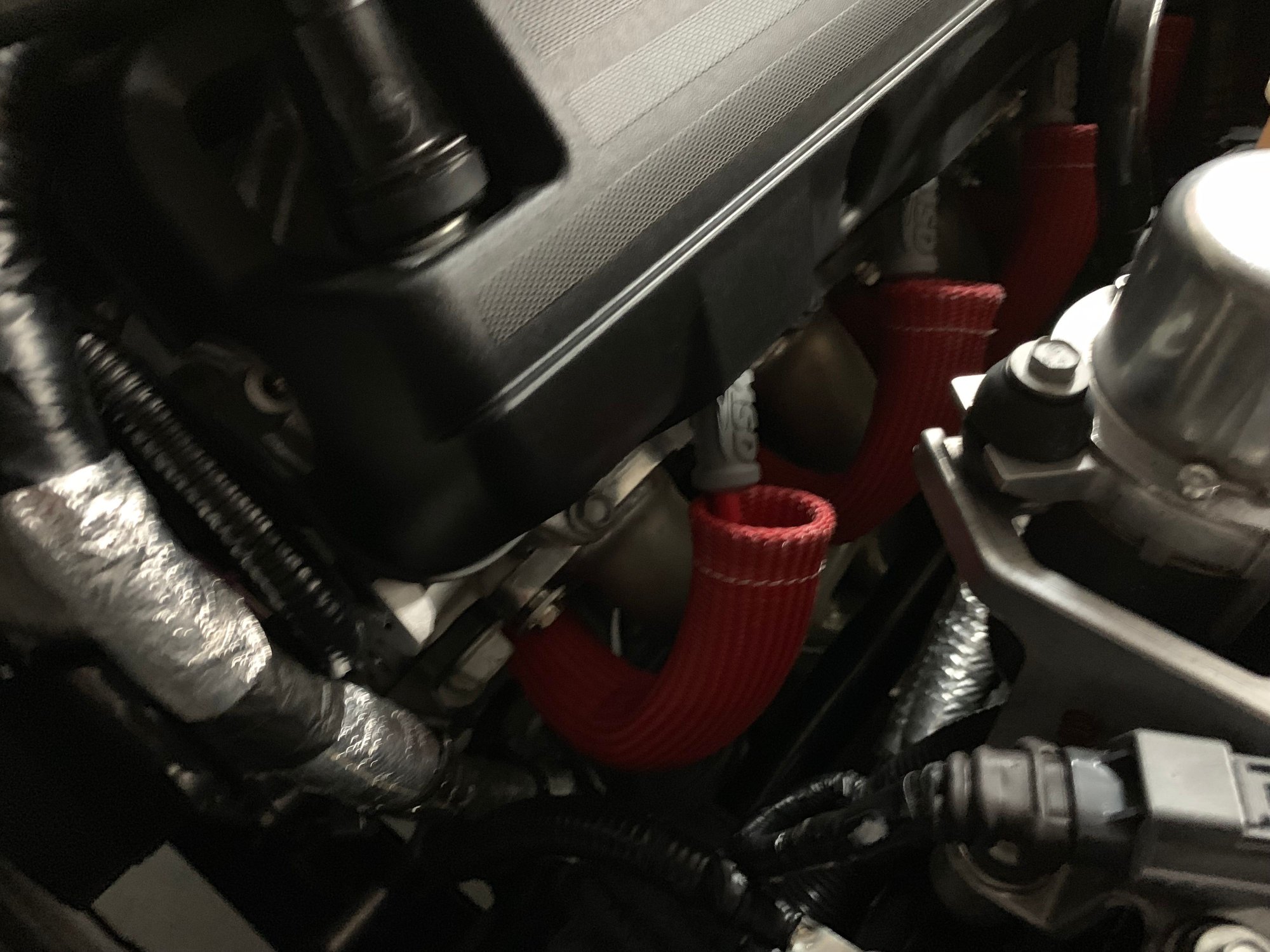

You'll love them! But I have to ask, are you DIY or having a shop install? I wrestled with both and finally went with a shop and I helped do the install and it still took 8hrs for two of us. Very tight working area. Anyway a few items to consider as well...
1) Stage 8 Locking Header Bolts... you do not want to have to re tighten loosening bolts because you wont be able to get to them!
2 Header Coating , I went with JetHot but there are several out there who are good, just to keep engine bay temps down.
3) Header Wire Plug Wraps (heat protection for spark wires...
Up to you I am just throwing out some additional items I decided to add... which means I had to sit and stare at my headers in the garage for a few extra weeks till i'd gathered it all.
Good Luck!
