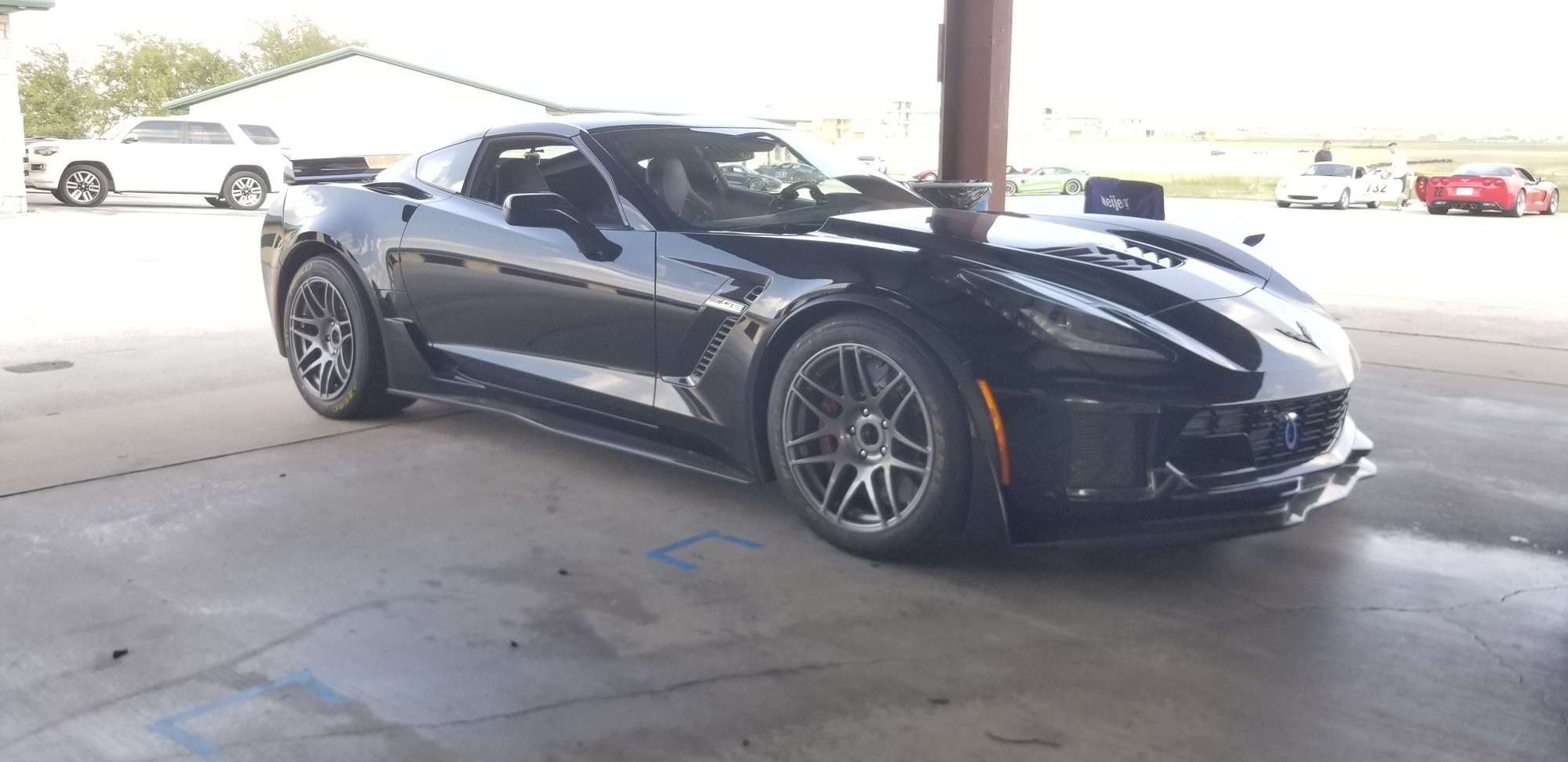

The front pads are the same as the non-z07 iron rotor size. 1405. Same as Camaro SS1le. Readily available.
The rear z07 pads are the same size as the z51 front pads. I forgot the number right now. Also readily available.
This is what I run on my car. With pads from my old z51.
Sorry only picture I got right now.
