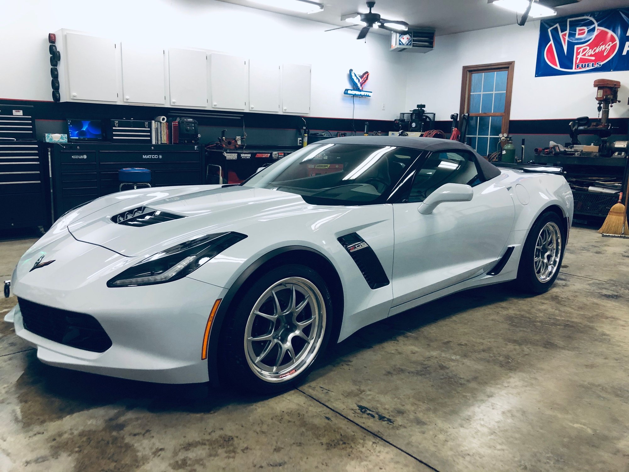

Currently running MT 325/35/18 R's on Forgeline 18" x 12" rear wheels.
Want to switch to a MT S/S and have 2 choices - 305/35/18 or 345/35/18.
Does anyone have first hand knowledge regarding any clearance issues with the 345/35/18's?
The 305/35/18 are overall smaller than the 325/35/18 and not sure I want to loose tread width, etc.
Thanks!

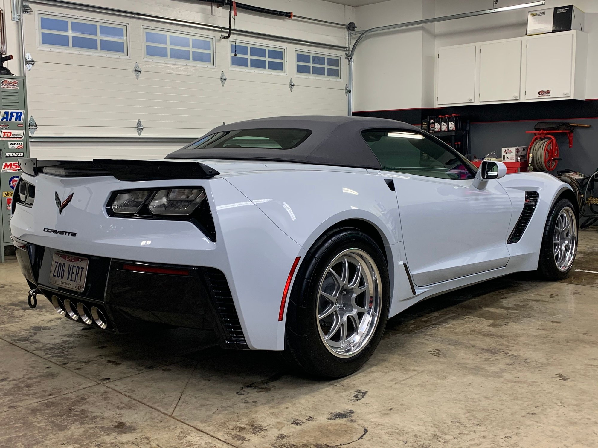

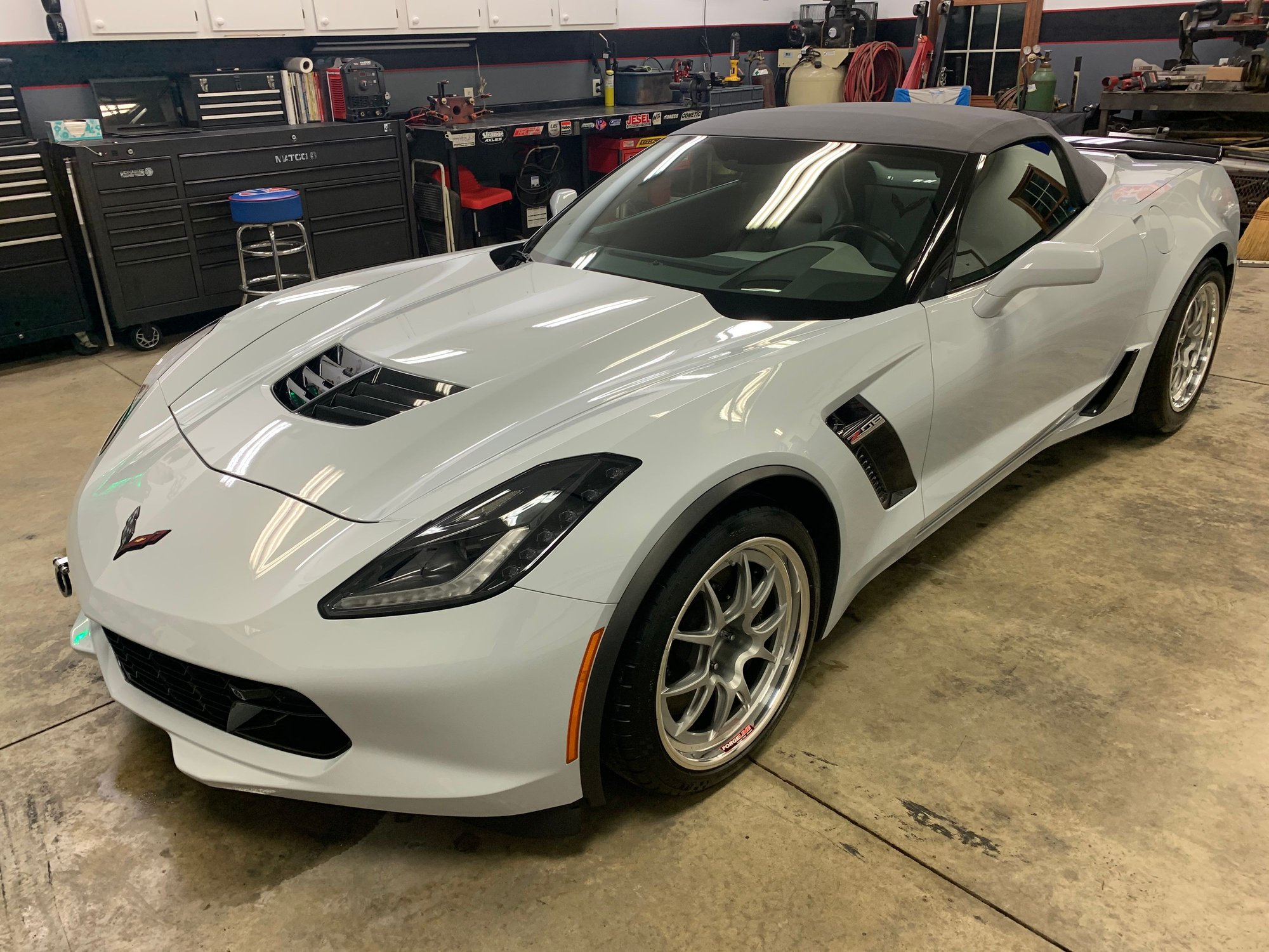

Any chance you could pm a pic? Would like to see the sidewall mounted.
Also, did you need to do anything regarding a tune or speedo calibration?
Thank you!

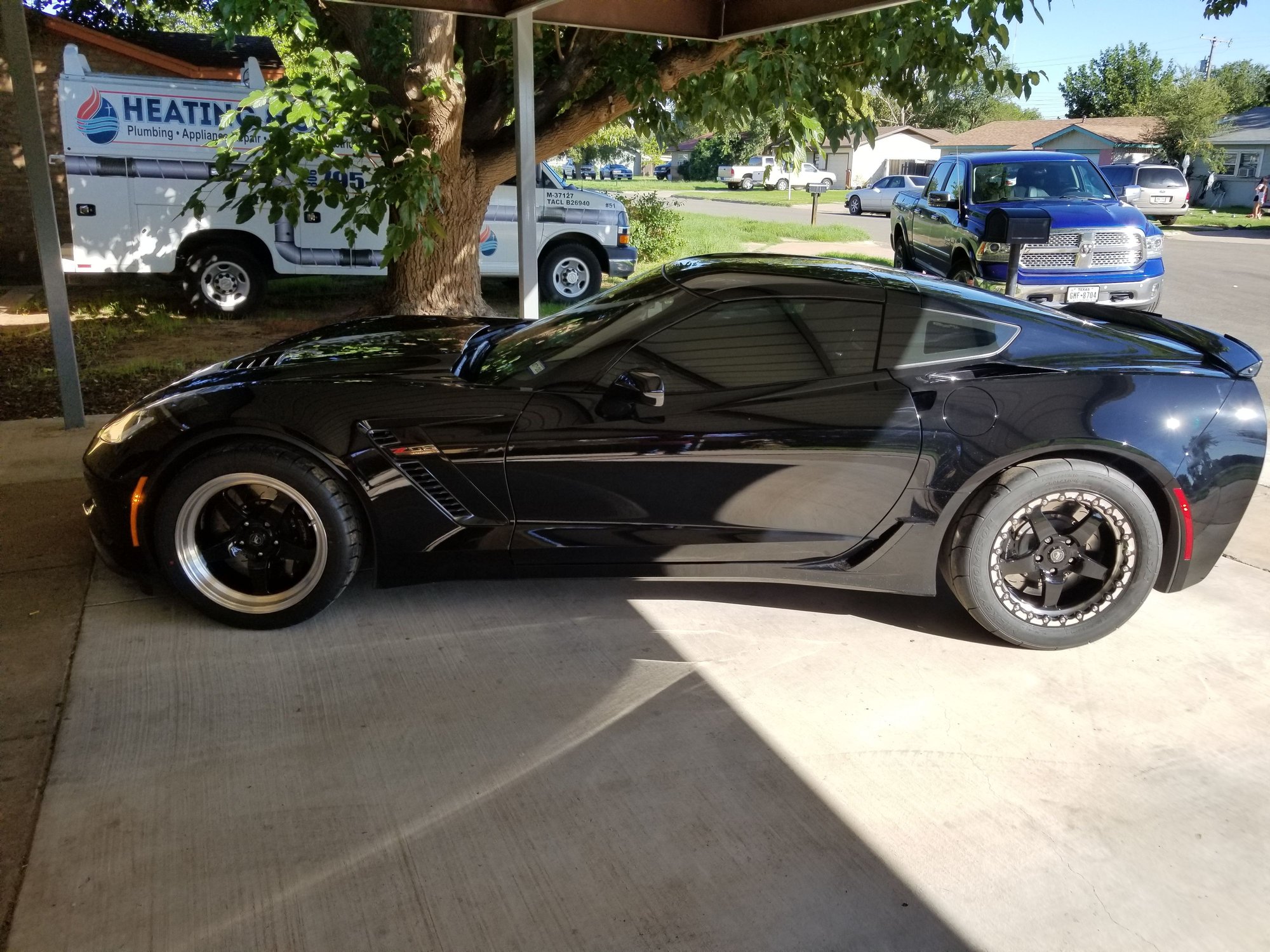

Here are my fat *** 345 MT SS tires.

Nice!! Did you need to do anything with your tune or speedo calibration?
Thank you.
Old Oct 12, 2019 | 11:40 AM
orrwhat's Avatar
orrwhat
Joined: Jul 2019
Posts: 411
Likes: 100
No, the tire height is very similar to the stock tire.
