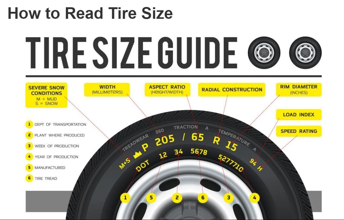

You run 305/30/20 on your rear? How would that compare to a 285/30/20 on a 20x11? I know nothing about tires. What does 305 and 285 mean? Thanks.

305 is wider than 285.....
