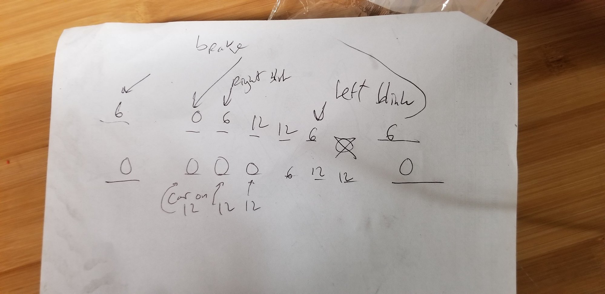

the big harness that goes to the rear bumper, best way is to just grab a multimeter and turn each blinker on at a time and see which pin goes to 12 volts. In any case. Here they are on my 2015 z06.
Thanks again. I think that I will use the small harness at each light assembly and go straight down with a small plug. I am installing these cool blacked out lights that go where the reflector is on the rear diffuser. they actually have run, brake and a sequential turn. They are pretty cool.
