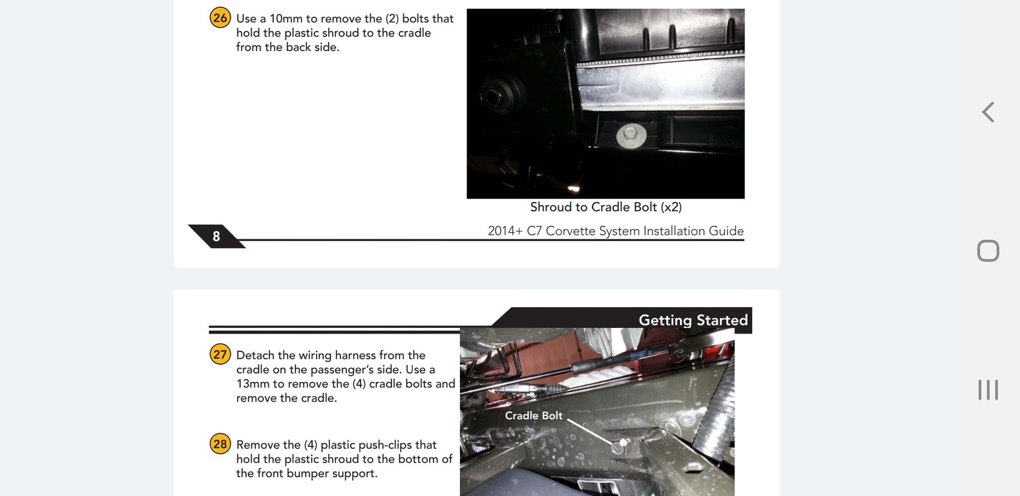

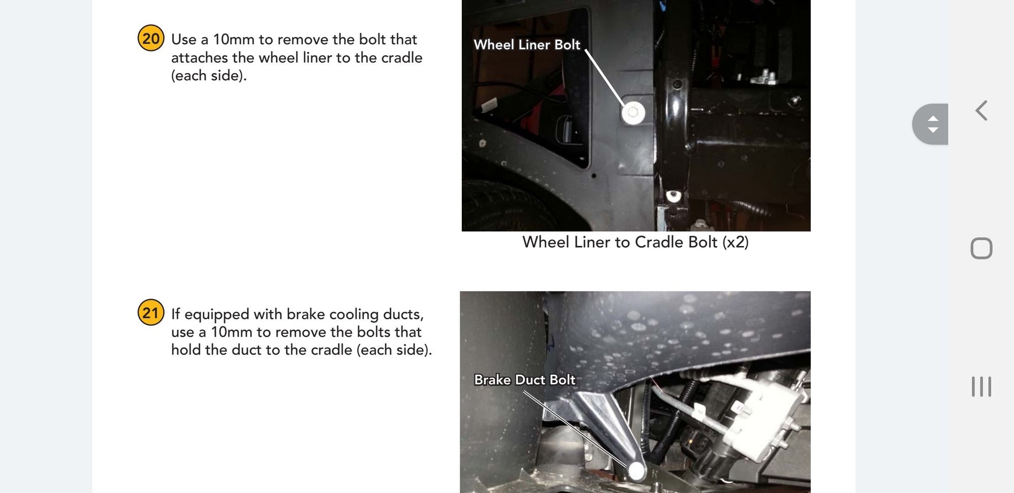

Use some heavy duty zip ties and hold up the radiator. No problem after that. The radiator probably won't move because of all the stuff bolted to it but it's better not to flex something else when you pull the support out. Here you go:

Bruno, that’s excellent info—the pictures are very helpful. Thanks. Still waiting on the part to arrive, but I’ll report back.

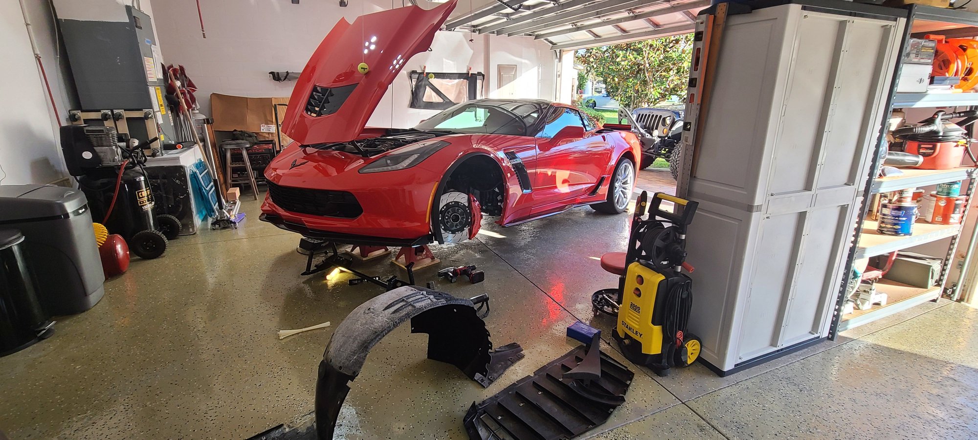

I did! I guess I forgot to post a recap here. Ahhhhh, memories. Anyway, it was basically four bolts for the radiator support, and a bunch of small screws that hold the front fascia and air dams in place.
Also, be careful with the clips that hold the electrical wire bundles in place. If you break one, I would simply zip-tie it in the same place rather than worry about finding the exact same clip.
My fender liner was also tweaked out of place, and the bracket holding the bolts to the frame was bent such that getting to one of the bolts was difficult. In short, it took some persistence to get everything off that needed it, but I finally succeeded. I could see how in some extreme cases you might need a way to cut the radiator support off, but hopefully not for you. Try to have a few different types of wrenches and extensions to get at those bolts.
It also might be a good idea to secure the radiator with some (very) big zip-ties, as I think was mentioned here by someone else.
I did it in my garage with the front end up on jackstands and ramps under the wheels. Then I strutted around the house shirtless for an hour or two as an outward display of my mechanical prowess.
