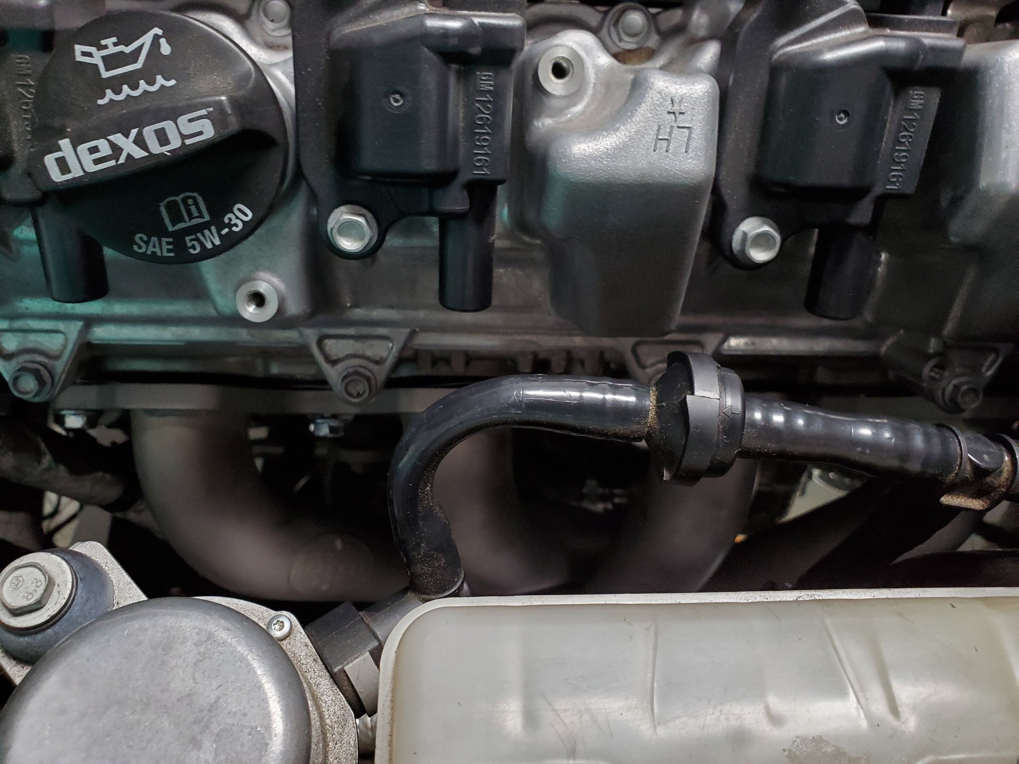

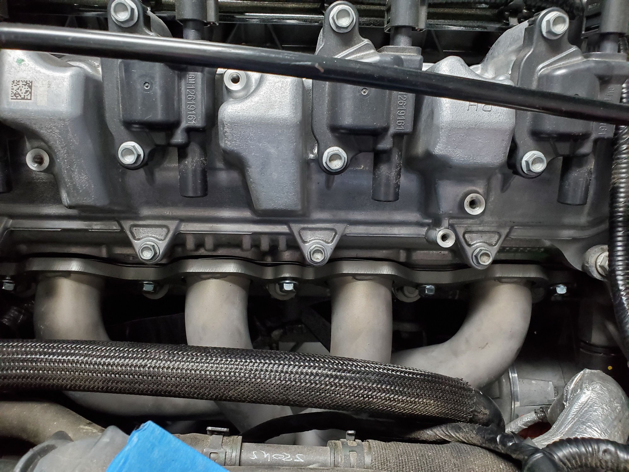

Although these pictures do not show the plugs installed you can clearly see that there is plenty of room for them , I cant see how other brands would be different unless you are going with a larger diameter tube

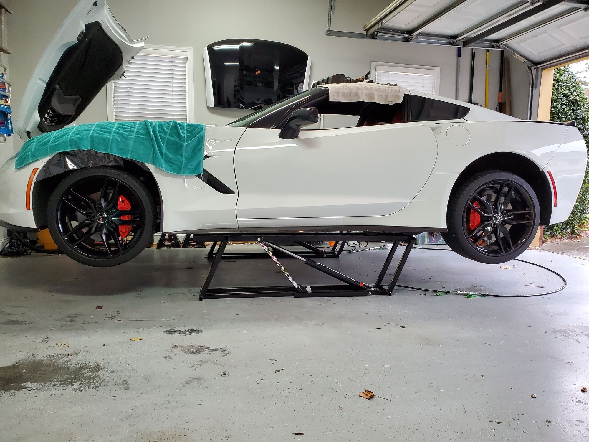

I did mine on a Quick lift so I dont think it was much higher than yours on 8 inch blocks , just PM me or email me as I would be glad to help
