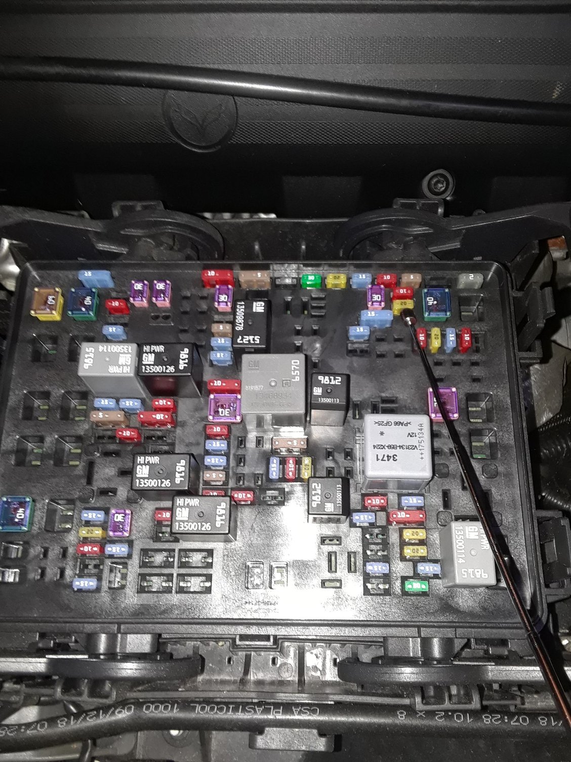

Originally Posted by limuzinshchik
what kind of fuse to remove that would disable them NPP
It's the exhaust/NPP fuse F87 in my 2019. Called exhaust valve. When you remove, it leaves the valves open all the time.

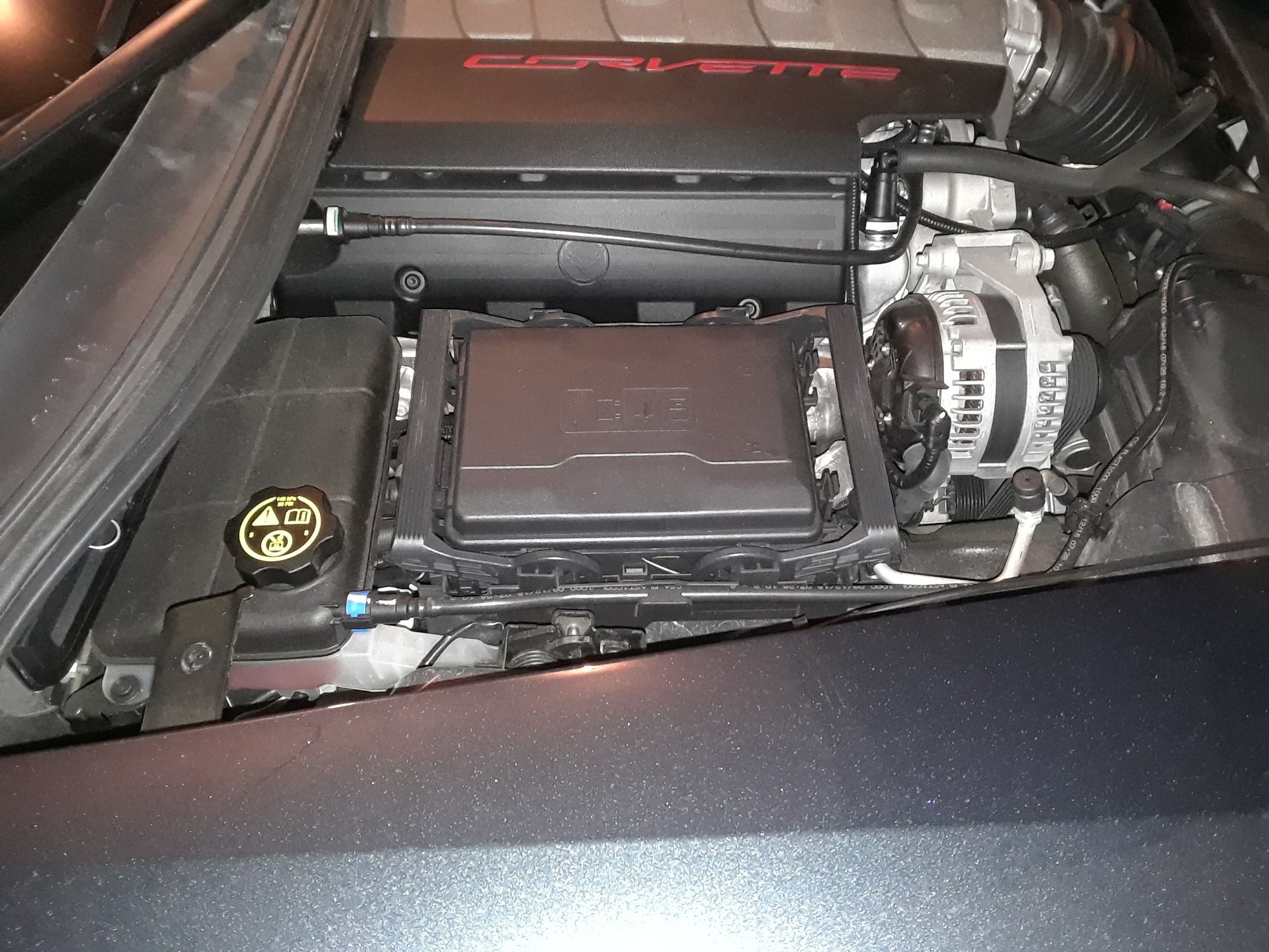

where it is installed, please give a photo
Hi, the engine bay passenger side fuse box. Remove the cover look at diagram and it is F87 Exh valve. In the pic I am pointing at the 20 yellow fuse. Remove that one. You can also just go to your settings, engine sound management and select track and I believe the exhaust will always be open then too.
